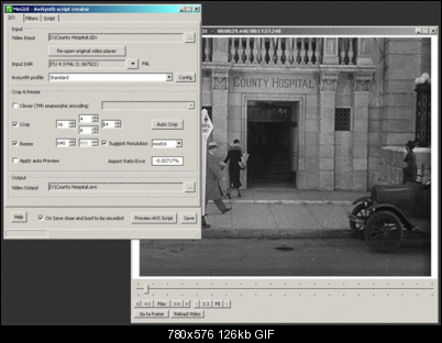

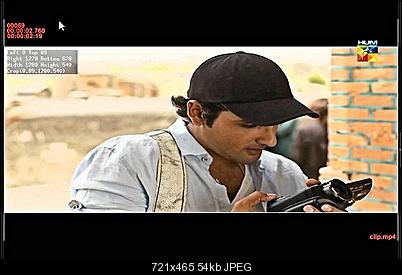

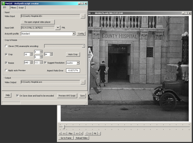

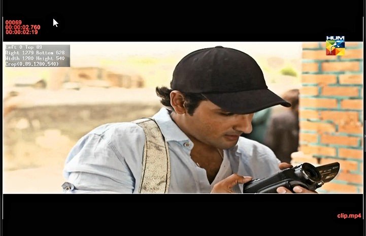

    Did you ever try the AVISynth external 'Autocrop' Filter. It's pretty accurate and even inserts the lines to view. with a crop example for the scene. If you use a player with frame by frame (Potplayer, FFplay and others) you can view as you go.
    My sample script is:
    DirectShowSource(("C:\Users\Bud\Desktop\clip.mp4") , Pixel_Type="yuy2").autocrop(mode=1, threshold=80)
    Subtitle("clip.mp4", font="Arial", size=24, text_color=$ff0000, align=3)
    ShowFrameNumber(scroll=true, x=10, y=27, font="Arial", size=24, text_color=$ff0000)
    ShowTime(x=72, y=44, font="Arial", size=24, text_color=$ff0000)
    ShowSMPTE(fps=25, x=68, y=61, font="Arial", size=24, text_color=$ff0000)
Name:	ScreenHunter_70 May. 21 21.57.jpg
    You can then edit the AVS for autocrop mode '0' and crop it for use in such as Virtualdub.
