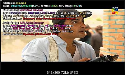

    Please see attached file. I want to crop out the black edges of the screen.
    In 16:9, they are at top and bottom, while in 4:3 they are also on the right and left. (i prefer 4:3 being natural).
    Thanks for help.
    Just zoom on your tv/software player.
  3. Just about every video editing program has the ability to crop the frame. That video 1280x720 but it should be 4:3 DAR, not 16:9 DAR.

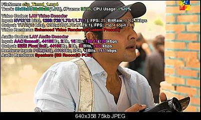

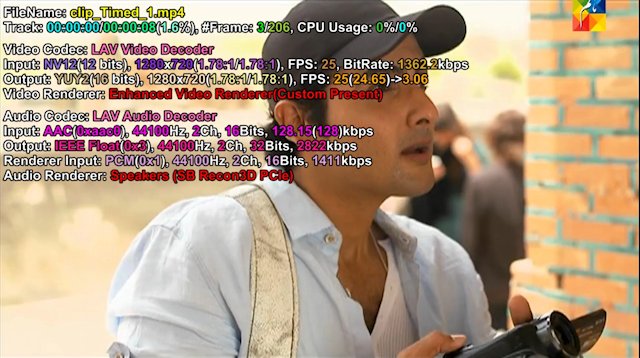

    Actually I think someone squashed the height, or as you say Jagabo, stretched the 4:3 out to 16/9. If you crop it and restretch it, 16/9 look pretty accurate if you check the faces and camera lens.

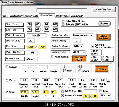

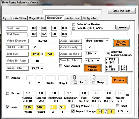

    Thanks for the screenshots. In which software have you cropped and restretched it? I am interested in cropping because my PC screen is already small and I dont want to waste screen size in blank edges therefore I want to crop them out.

  10. Crop and Resize are in the video transform filters of AviDemux.
