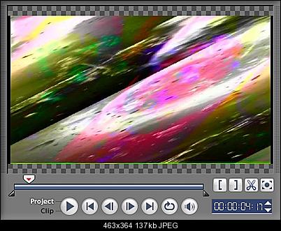

  1. I wasn't sure whether to post this in the editing or the converting forum since it's a little bit of both, but I have made a bunch of video clips that while they play perfectly when I open them in Windows Media Player, and even within Corel Video Studio itself, the minute I drop any of them onto the timeline, the video becomes distorted, like seen below:
    I used MediaConverter 8 to make these video clips. The source files I made them from were all MKV and the clips I made are all WMV. This distortion problem only presents itself within the video studio timeline as far as I can tell. Is there a way to fix this issue without having to remake every single clip? It was a rather time-consuming process to begin with and I would really hate to have to start all over again and delaying my project.

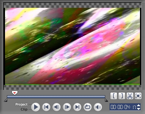

    .wmv files are handled fine (for me, anyway).

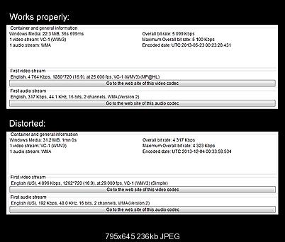

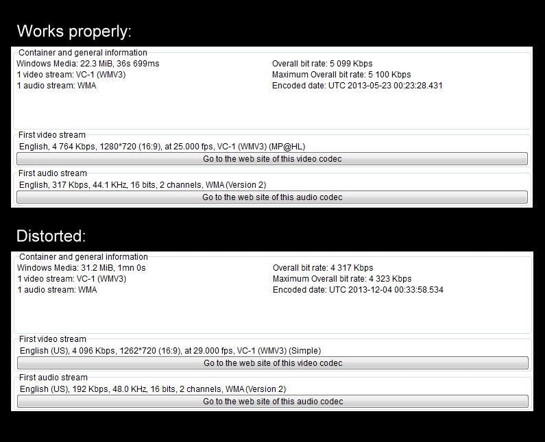

  8. Wouldn't let me copy/paste so took a screencap:
  9. Likely it's the 1262 width dimensions . Many programs / decoders require mod4 compliance (evenly divisible by 4)
    Your options are to resize & re-encode , or use another program
  10. Originally Posted by poisondeathray View Post
    Thank you, I changed the resize protocol to letterbox so that the end result always is 1280 no matter what and the new clips now worked without a problem
