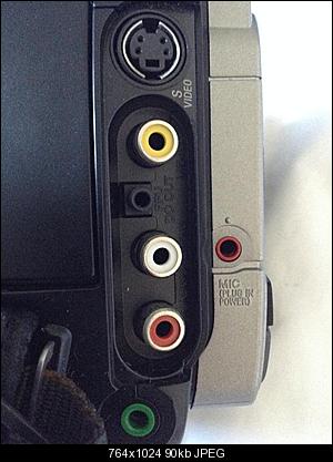

    These are the sockets available on the TRV65E Hi-8 camcorder

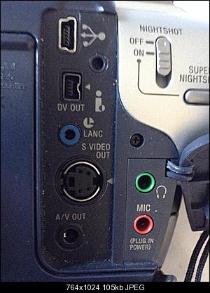

    And these are the ones available on the TRV17E mini DV camcorder

  2. That model DV camera has no input connectors. It will not work.
  3. Ah alright, what do you mean by input connectors? And do you know any other relatively cheap models that I could use and how I could do it? Sorry for all the questions but I'm a newbie and I really want to get this footage digitised
  4. Member Cornucopia's Avatar
    Most of the time, those connections are one way. Either incoming or outgoing. For a Dvcam to work for what you want, it has to have 3 features: an input compatible with your other cam's output, "analog passthrough" capability, and a dv/FireWire output. Yours has the last, but not the first 2.
    Your choices:
    Get a digital8 cam instead.
    Get a canopus/gv adc-100 or similar converter box to go between the hi8 cam & pc.
    Get an analog capture card.
    (If you only have a few) use a service
  5. Thank you for the advice! I've been doing a bit of poking around about Canopus and I was just wondering whether I should by a ADVC - 100 or an ADVC - 110, I can't seem to figure out what the difference between the two is
