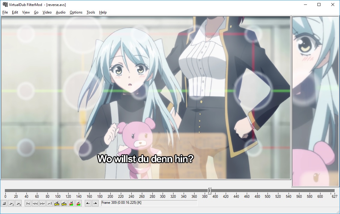

Here's an example that combines a mask for greys and a mask for blacks then masks off only the subtitle area near the bottom of the video:
Code:function PackRGB(int r, int g, int b) { return(r*256*256 + g*256 + b) } LWLibavVideoSource("greysubs.mkv") src=last greymask = ResetMask(ConvertToRGB(src)).ColorKeyMask(PackRGB(203,203,203), 15, 15, 15).ShowAlpha().ConvertToYV12(matrix="PC.601").mt_inpand().mt_inpand() blackmask = ResetMask(ConvertToRGB(src)).ColorKeyMask(PackRGB(15,15,15), 15, 15, 15).ShowAlpha().ConvertToYV12(matrix="PC.601").mt_inpand.mt_inpand() submask = Overlay(greymask, blackmask, mode="add").Invert().Crop(350,540,-350,-48).AddBorders(350,540,350,48).ColorYUV(cont_y=40).Blur(1.0) overlay(last, GreyScale().ColorYUV(cont_y=200), 0, 0, mask=submask) Interleave(src, last, submask.ConvertToYV12().GreyScale()) -
I interleaved the original video, the updated video, and the mask -- so you can open the video in an editor, step through frame by frame, and see exactly what's going on. Remove the last line to get just the updated video.

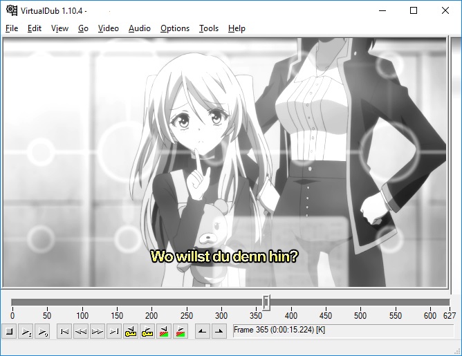

Someone has an idea because it is now shown in black and white with avisynth+.
[Attachment 43857 - Click to enlarge]
This script it showed correctly with my previous avisynth.
Thanks in advance. -
Yes, the image post #11 was made from that video and that script. Just ran it again and verified it works.
It's a regression. Will be fixed in next AviSynth+ release.
https://github.com/pinterf/AviSynthPlus/commit/3c9ff6c89663d3d679c63aa9815c20c3dce74e0f -
Like this?
Code:ffVideoSource("cut.mkv") mask=MaskHS(160,180, 100,80).mt_expand().BilinearResize(last.width, last.height) inv=Invert(mask) #workaround for broken AVS+ r2173 to r2544 overlay(last, GreyScale().ColorYUV(cont_y=50), 0, 0, inv) -
@ sneaker
Apparently it works.
but the subtitle appears with some blocks of yellow.
[Attachment 43860 - Click to enlarge]
Modifying the script with 'mt_inpand' the sub show much better,...is this correct?
mask=MaskHS(160,180, 100,80).mt_inpand().BilinearResize(last.width, last.height)
[Attachment 43861 - Click to enlarge]
I had changed to avisynth+ and wanted to start all my samples script.
Now I'm satisfied.
Thanks sneaker, jagabo.Last edited by sekininsha; 29th Nov 2017 at 23:16.
