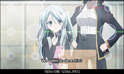

  10. Here's a variation I came up with using a greyscale (contrast enhanced) version of the video as the replacement color:
    ffVideoSource("cut.mkv")
    mask=MaskHS(160,180, 100,80).mt_expand().BilinearResize(last.width, last.height)
    overlay(last, GreyScale().ColorYUV(cont_y=50), 0, 0, mask)
    You'll need mt_masktools to use mt_expand(). If you want to use the single threaded Expand() (in the Masktools package) instead of mt_expand(), ConvertToYV12() before Expand().
    mask=MaskHS(160,180, 100,80).ConvertToYV12().Expand().BilinearResize(last.width, last.height)

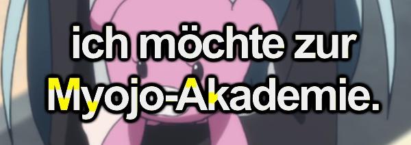

    It's leaving some blocks of yellow in the OP's sample.
    Sep 2012
    Australia
    I've saved it as an AVI and have gone through every frame and I'm not seeing that. Which frame are you getting that from?
    -Edit- Maybe you have a different version of mt_masktools because it looks like BMask isn't reaching the center of those joins. Add another mt_expand and another mt_inpand. It's suppose to expand the black mask to fill in the space occupied by the Yellow colour, then shink it to make external black lines disappear completely. Only yellow contained within a black outline should survive.

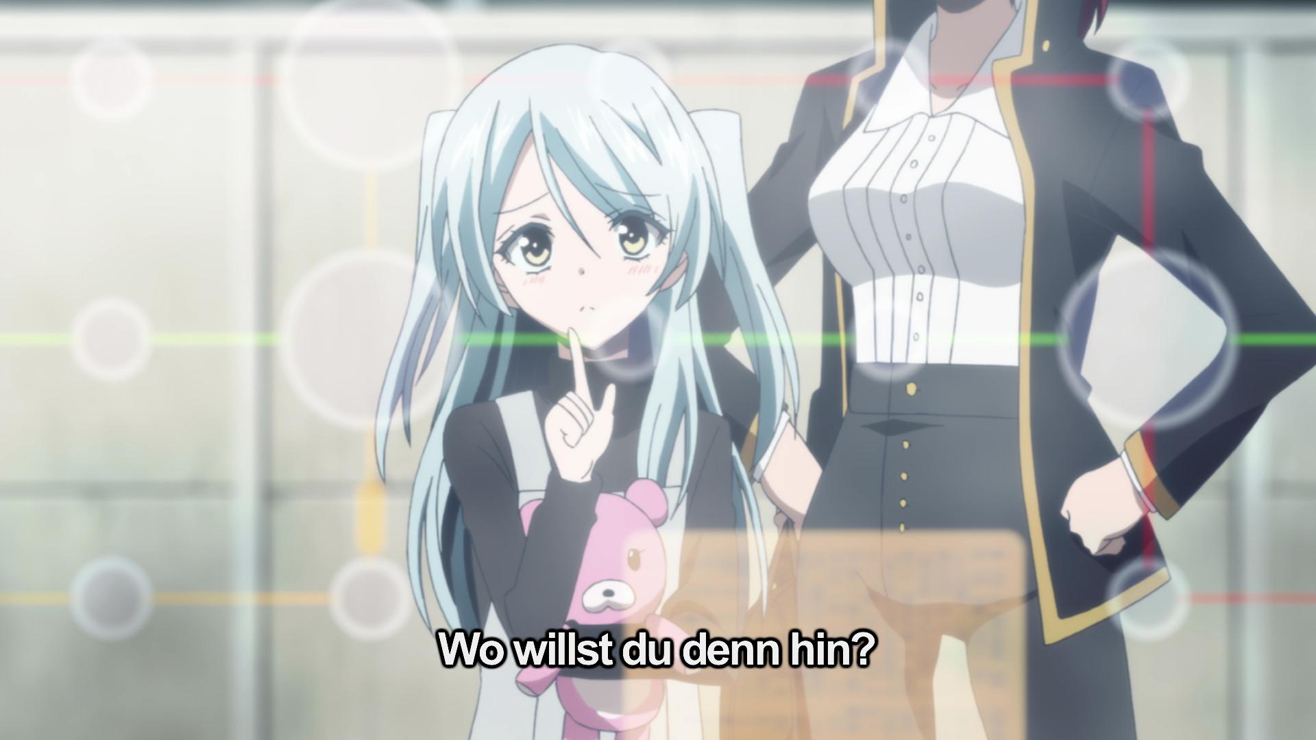

  27. Originally Posted by Ninelpienel View Post
    [Attachment 25221 - Click to enlarge]

    This was great, but now on this video are yellow dots in the subtitle:
    Just tweak the MaskHS values a bit. Changing the 100 to 105 took care of it.
