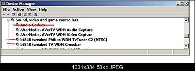

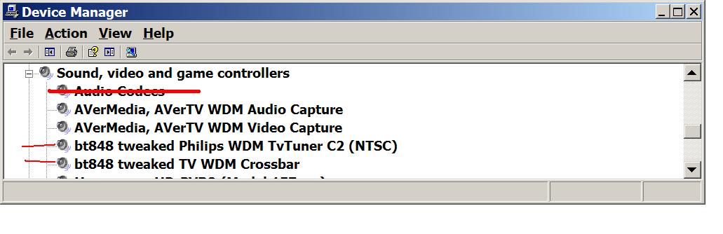

    Funny but I have that exact card working on one of my computers right now. I used the drivers from this site that go back to 2002
    http://www.iulabs.com/drv/download.shtml
    The download file name is "848wdm_iu.zip". I know the drivers say 848 but they work. I can't recall for sure since it's been a while but the last time I did the install I couldn't get a good combo of the 4 drivers so I left the Avertv audio and video capture drivers installed and just manually updated the crossbar and tvtuner by pointing to the extracted inf files and selecting the drivers myself from the list.
    There's another link to newer drivers by someone name Edwardo at the bottom of the page in the above link. I've never tried those but maybe if you have issues with the way I did it you could try those. On closer inspection I recall using Edwardo's drivers too but I found them a different way. I had to do a manual install and it took a while to get the tuner and crossbar right so the last time I re-installed I went back to what I posted in the pic above.
    btw) Virtualdub or any program that recognizes wdm drivers should work with these drivers. When you capture remember to choose the "Conexant" device to get the wdm drivers. You can use xvid compression I think it's available stand alone or within ffdshow (Old rust showing here) or get the free pre-HD divx codecs.
