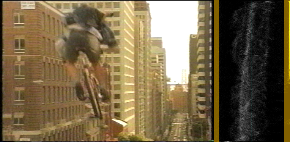

  30. Formerly 'vaporeon800' Brad's Avatar
    Apr 2001
    Vancouver, Canada
    Originally Posted by Opticum View Post
    alot of people in the german vhs capture scene moved to Panasonic DVD Recorders with HDMI Out and a HDMI Capture Card
    Do they not get blown-out whites with PAL sources like I do with NTSC using the DMR-ES25's HDMI output?
    You can see on the histogram below it's hitting the hard limit of 255 in YUV. It doesn't happen all the time, but inevitably on a 6-hour tape of TV content, there will be some scenes that bloom. Changing the input setting from "Lighter" to "Darker" doesn't help; it simply clips superblacks.
