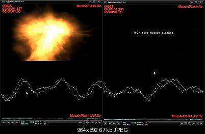

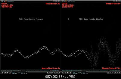

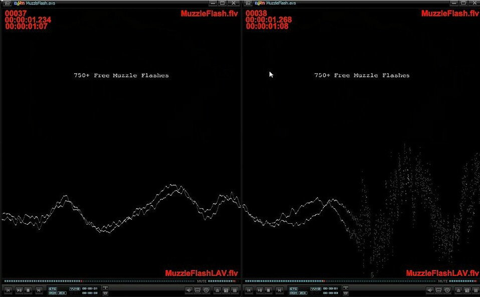

    It is possible to create a video of the soundtrack using LAV filter and display against the video.
    Above shows the sound is delayed approximately 100 ms

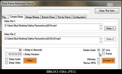

    You can also view as lines instead of points:

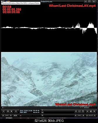

    This is done with FFMpeg and AVISynth. If you are familiar with these then use the following script, making sure it is same size, format, etc as the original:
    ffmpeg -ss 00:00:00.000 -f lavfi -i "amovie=../../../../../../../../../Users/Bud/Desktop/NameOfVideo.mp4,asplit[out0],showwaves=r=29.970=640x320:mode=line[out1]" -r 29.970 -s 640x320 -vcodec libx264 -vsync 1 -y "C:\Users\Bud\Desktop\NameOfVideoLAV.mp4"
    Then just Stack them using AVISynth:
    v1=DirectShowSource("C:\Users\Bud\Desktop\mpg test\NameOfVideo.mp4", Pixel_Type="yuy2")
    v2=DirectShowSource("C:\Users\Bud\Desktop\mpg test\NameOfVideoLAV.mp4", Pixel_Type="yuy2")
    stackvertical(v2, v1)
    Subtitle("NameOfVideoLAV.mp4", font="Arial", size=24, text_color=$ff0000, align=9)
    Subtitle("NameOfVideo.mp4", font="Arial", size=24, text_color=$ff0000, align=3)
    ShowFrameNumber(scroll=true, x=10, y=27, font="Arial", size=24, text_color=$ff0000)
    ShowTime(x=72, y=44, font="Arial", size=24, text_color=$ff0000)
    ShowSMPTE(fps=30, x=68, y=61, font="Arial", size=24, text_color=$ff0000)

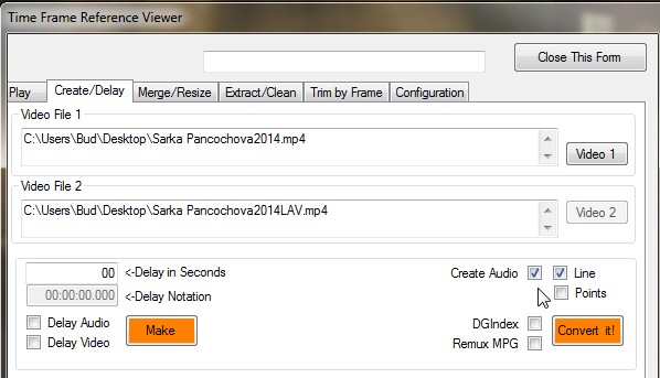

    I am currently debugging beta that does it for me:
Name:	create audio.jpg
