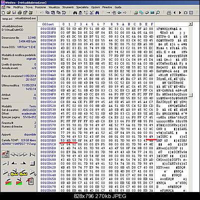

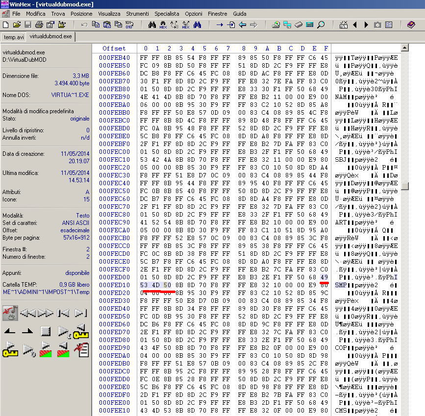

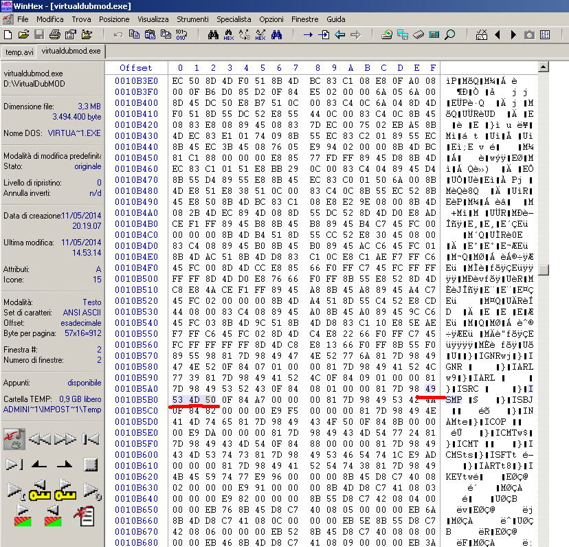

    Anhoter thing: I have modify virtualdubmod.exe with hex editor
ID:	25161Click image for larger version
  7. ISMP in place of ICRD :=)
    otherwise it don't means "timecode"
    NLE recognize "timecode" as "ISMP" Image
