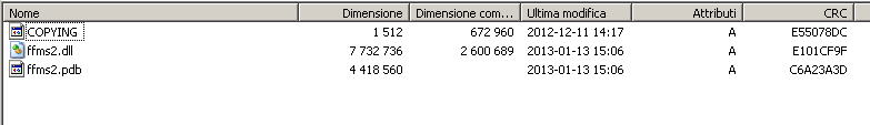

  16. I have installed avisynth 2.5.8 wi this ffms2 plugin:
    semms it don't have ffmsindex.exe, or don't need it however my proof is:
    DirectShowSource ("26.mxf") = immediate opening in VDM
    FFVideoSource("26.mxf") = 1-2 minutes to opening in VDM
    if if there a way to immediate opening, maybe pre indexing, whit the ffms2 plugin would be a good idea
