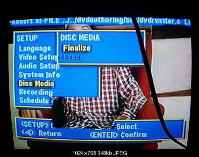

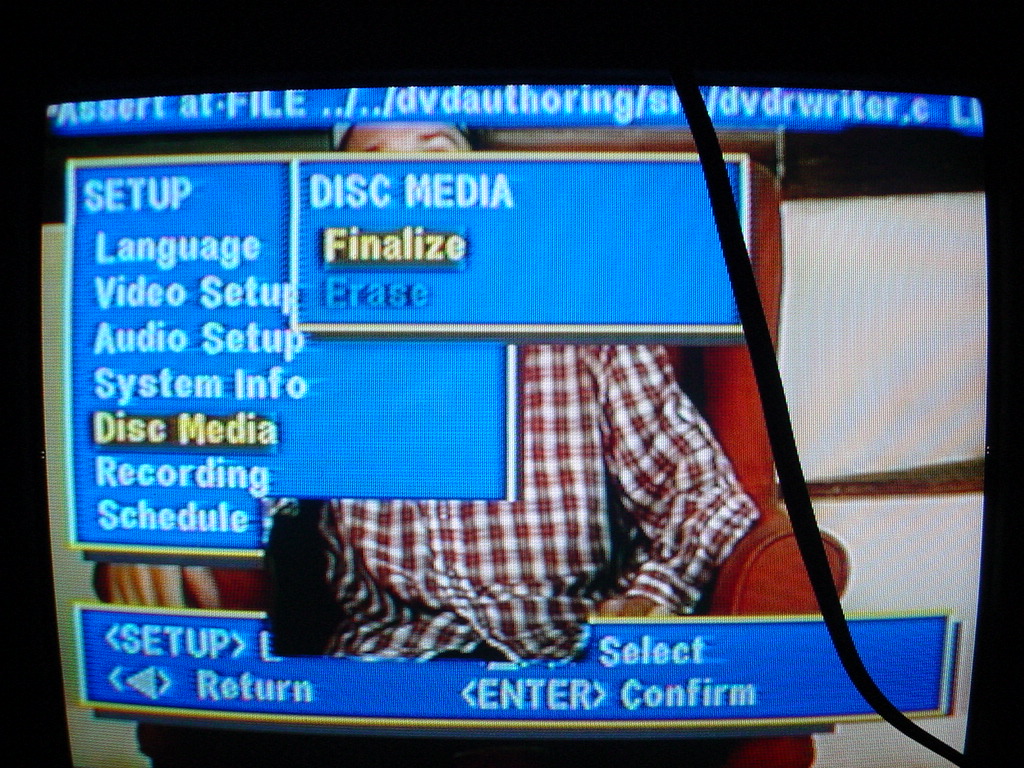

    Hi all I'm new here so howdy. I have some discs I recorded on a Medion dvd recorder I never got around to finalizing. The dvd recorder quit working so I bought the same model Medion dvd recorder from eBay with the hope I could finalize those dvds on the new recorder. They play fine and the title lists look the same as the other one but for the 2 discs I tried to finalize, they ended up not being able to be read at all by the Medion or any other dvd player after finalizing. I got a message at the top of the screen right after trying to finalize those 2 discs but don't know what it means, maybe someone here does, here's a picture of it.Click image for larger version

    How do they react in a computer?
  3. Member DB83's Avatar
    Jul 2007
    'Same model' would have to mean same physical model AND same version of software. Since most units are 'badged' there is no guarantee that another unit can finalise these disks.
    The message appears to refer to the software. You can always try to update that but also run the risk of 'bricking' this unit in the process.
    Better to 'rip' the disk contents using software such as iso-buster and re-author the dvd in a PC.
    If all your other disks play in the new machine better even then to get another recorder(maybe try and borrow one) and copy/dub from the playing machine to the other one and finalise in the recording one.

    The message you see is an unhelpful error message that would be of use only a programmer who worked on the firmware code for this model. It could mean anything.
    Are your discs re-writable? Approximately how old are they and what brand are they? Maybe you are finalizing RW discs and due to age you are having problems. RW discs aren't meant for permanent storage. Even if properly stored they will destabilize after time. As jjeff points out it is very unusual for finalized discs to become unplayable after finalization. There is also a chance that the finalization failed and the discs are not RW but normal write once DVD-R or DVD+R and the failure of finalization is causing your playback problems. If so, you'll have to use ISO-Buster and hope it can read your discs.

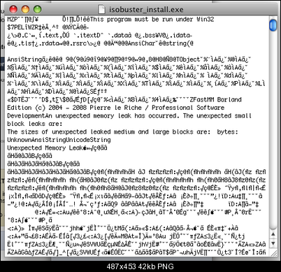

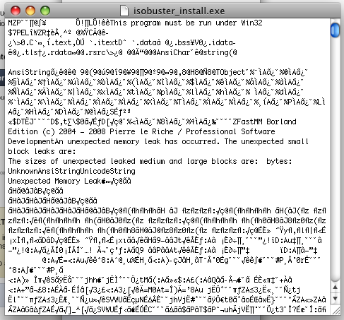

    OK I tried the free version and apparently it doesn't work with a Mac. The picture I included is what I get when I try to run the program which is typical of a Windows program on a Mac. So no need to worry about ISO-Buster anymore.

  14. Member DB83's Avatar
    Jul 2007
    Of course Windows programs will not wok on a Mac but you can install Windows on a Mac and run programs then.
