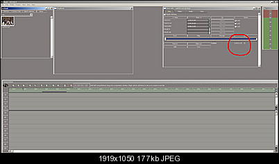

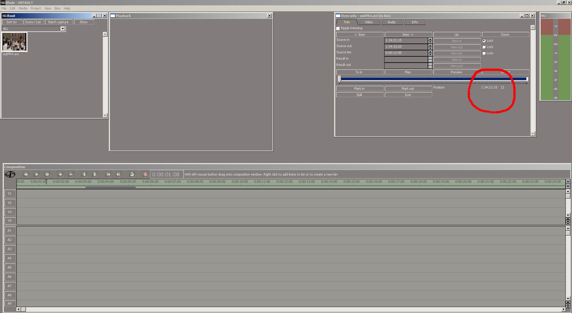

  4. ffmpeg can add metadata but can not generate mjpeg interlaced file.. so I'm force to virtualdub because with it I use the Morgan mjpeg codec v3 that can use interlace
    For the tag I have found a version of virtualdubMod called "VirtualDubMod 1.6.0.0 Surround" in wich I have modify with Hex editor the virtualdubmod.exe so tag ICRD [date] = ISMP
    Now virtualdubmod "see" timecode code as date, and I fill the filed "date" to add my timecode e.g. 01:34:21:15
    Resultat .vcf script is:
    VirtualDub.RemoveInputStreams();
    VirtualDub.video.DeleteComments(1);
    VirtualDub.video.AddComment(0x0000000C,"","01:34:2 1:15");
    VirtualDub.video.AdjustChapters(1);
    VirtualDub.video.SetDepth(24,24);
    VirtualDub.video.SetMode(1);
    VirtualDub.video.SetFrameRate(0,1);
    VirtualDub.video.SetIVTC(0,0,-1,0);
    VirtualDub.video.SetCompression(0x6a6d7674,0,10000 ,0);
    VirtualDub.video.SetCompData(28,"TUpQRxgAAAAAAAAAA gAAAAgAAAACAAAAAQAAAA==");
    VirtualDub.video.filters.Clear();
    and the NLE can recognize well timecode
