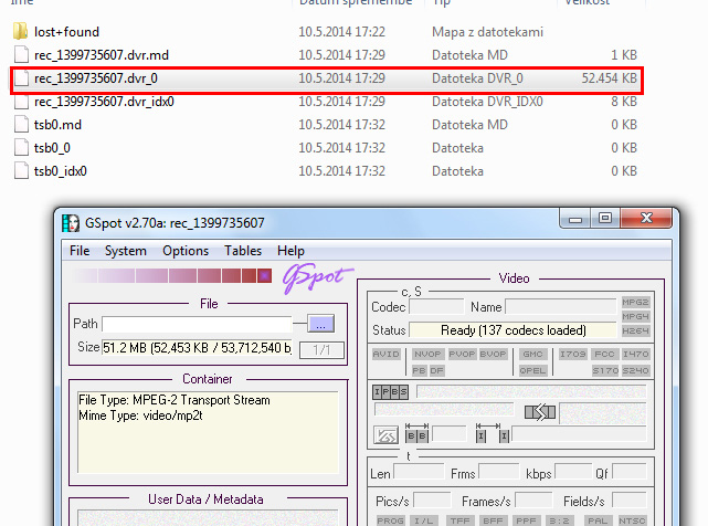

    Hi Im new here, and I got problem I cant play files wich I record on USB key with this cisco box 4682DVB I try with a lot diferent player's form BS to kmz, gom, VLC ... I try even rename that file extension to .mp2 .ts .avi and nothing happen.
    I try diferent converters to recode that video, and again nothin.
    Is any chance to watch that video on my PC ?
    thx for any informations.
    media info details of renamed file
    original file

    At first glance it looks like a bad muxing, or even a GOP situation, which can arise from a video put together on the fly from a capture.
    The first thing I'd try is to let VideoReDo recalculate the GOPs (Tools->QuickStream Fix). If you like, upload a sample so some of us can try it. (Also, it looks like a cool unit, and would love to see the quality. )
    What was the original extension? If it was M2TS or TS, you can play around with it in tsMuxerGUI (by remuxing).

    The Cisco 4682DVB appears to be made for use with cable TV service. My guess is that the Cisco 4682DVB encrypts the recordings it makes so they can only be played by the individual unit that made them. Cable TV DVRs tend to do that to prevent recordings from being shared with others who are not subscribers.

    I've never heard of even one DVR that encrypts what it records but consumers can break the encryption with a program. If unusually_quiet is right, your only solution is to play the recording and record it to a PC via a video capture device. You won't be able to just copy the program to a PC and "fix" it.

    Now Im a 99.9% is crypted or similar, because I read user manual from our TV provider (not cisco user manual) and say the files will be locked and you can play that file ONLY on device which made record, even same device will not play that video.
