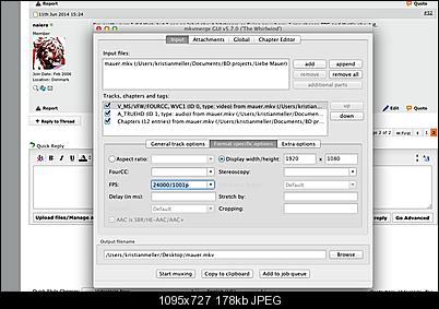

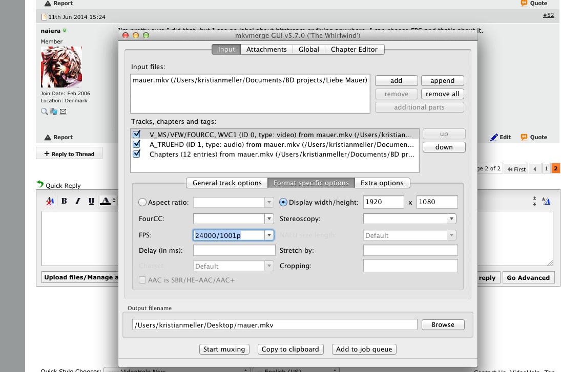

    I'm pretty sure I did that, but I see no label about bitstream or fixing anywhere. I can choose FPS and that's about it.

    Yup '24000/1001p', and the 'Fix bitstream timing information' checkbox under the 'Format specific options' tab of the MPEG4 H.264 stream options in MMG. Do I really need to load up MMG and check what everything is called each time I give advice

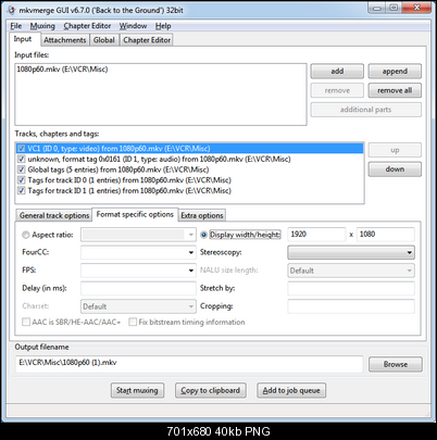

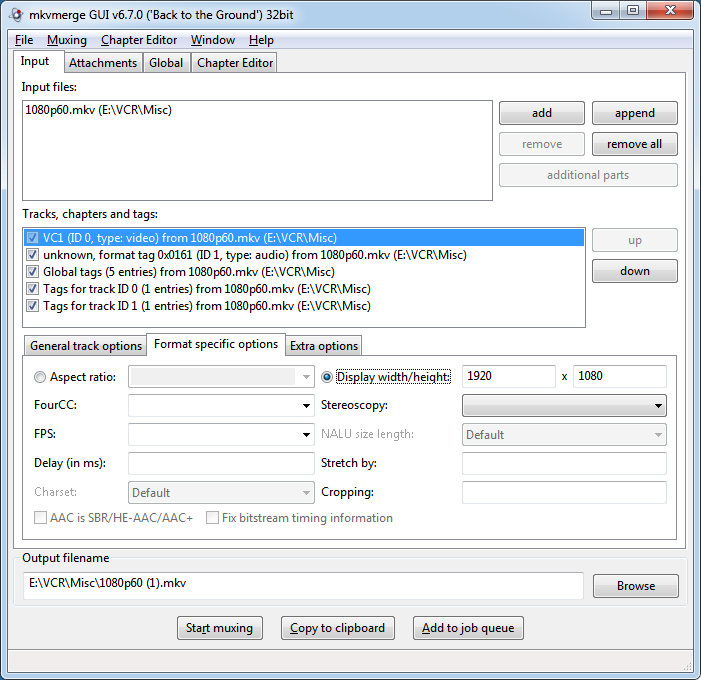

  27. Here's the Windows version:
    Note that the function is greyed out for WVC1 video. Maybe the Mac version doesn't even show it when it's not available. Try an h.264 video and see if the option shows up.
