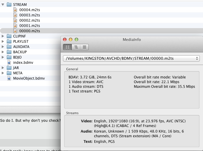

    Is this sufficient? I've only just tried MediaInfo for the first time.
    [Attachment 25140 - Click to enlarge]
    I have to split the files to make them compatible with the FAT32 USB stick.
  13. MediaInfo tells you the bit depth. Select View -> Text. Then look in the video section. One of the lines should read "Bit depth_______N bits".

  16. The video looks "normal" -- I don't see anything unusual. I wouldn't expect the Oppo to have trouble playing it. Have you tried remuxing it?

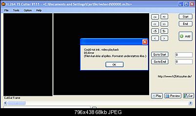

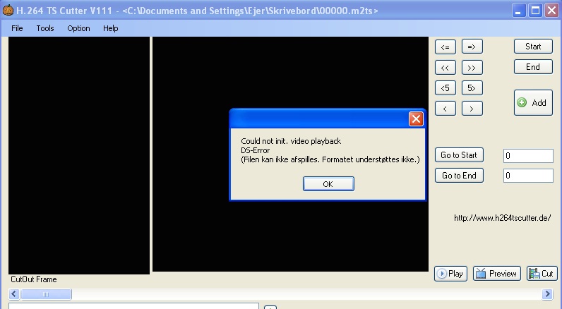

    You should be able to use a tool like h264tsCutter to cut out a short segment of the M2TS file. I think MMG has the ability to cut out a section from an MKV file -- I've never used it for that though.
    Don't we need to see the final result, rather than the ripped MKV file?
    I can't get H264tsCutter to like my m2ts file
    [Attachment 25148 - Click to enlarge]
    That means you don't have Windows' DirectShow set up to read and display M2TS files (you probably need an M2TS reader/splitter like Haali or LAV Filter, and maybe a DirectShow h.264 decoder). But I don't think you need to see the video to cut it (though obviously, it's easier). You can just mark off a 10 second clip in the middle of the file and save it.
