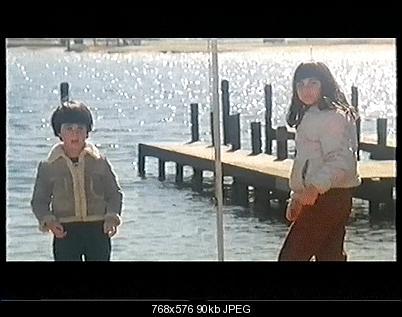

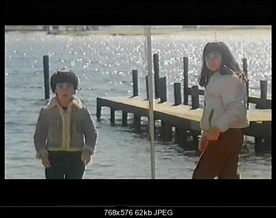

  6. The stable image is from medical vcr
    the disturbed one is from home vcr
    I see better colour in home,and better clearness on medical

  7. Sounds like you need to proceed on a tape by tape basis -- not so unusual. When you say the colors are dark how are you judging this, with a waveform and vectorscope, a properly calibrated monitor...?
    I see destroyed image on home.
  10. Originally Posted by smrpix View Post
    Yes,but don't care about this is for VCR alignment
    i see better colours on the home vcr
  11. If watching that picture pleases you, it's your right and your choice. Enjoy.
  12. Originally Posted by smrpix View Post
    Of course in this case i prefer the other one

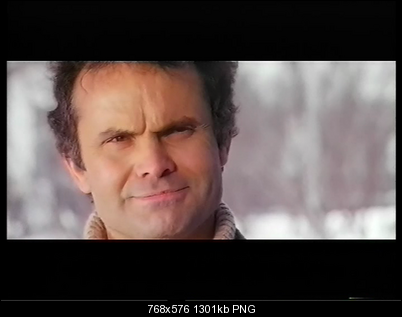

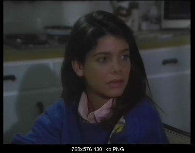

  13. Wich is better in your opinion?

  14. Member Cornucopia's Avatar
    While I think it needs tweaking in AVISynth afterwards (dyn range, saturation, some moire, etc), I personally like the medical Svhs vcr better.
    Here's an idea - why don't you use BOTH?! Transfer both to file, edit head+tail so they match frames exactly, clean them up in AVISynth (as best as possible for their own internal faults), then do an AVERAGE/MEDIAN of the 2. Common/similar parts (which are usually the good parts) will ~double in strength vs. the noise.
    BTW, I notice that the last example does NOT show frames from the same moment.

    I'm assuming the first one is from the LG since it has crosstalk.
    After post-processing, there won't be any huge difference. But a video sample will help.

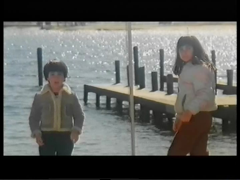

    I want only to backup my old vhs to digital format,only backup because vhs
    are not eternal.
    Did you think is really bad my vcr?

    They look horribly oversmoothed to me. But I believe that's whatever you're doing on the digital side, not the VCRs.

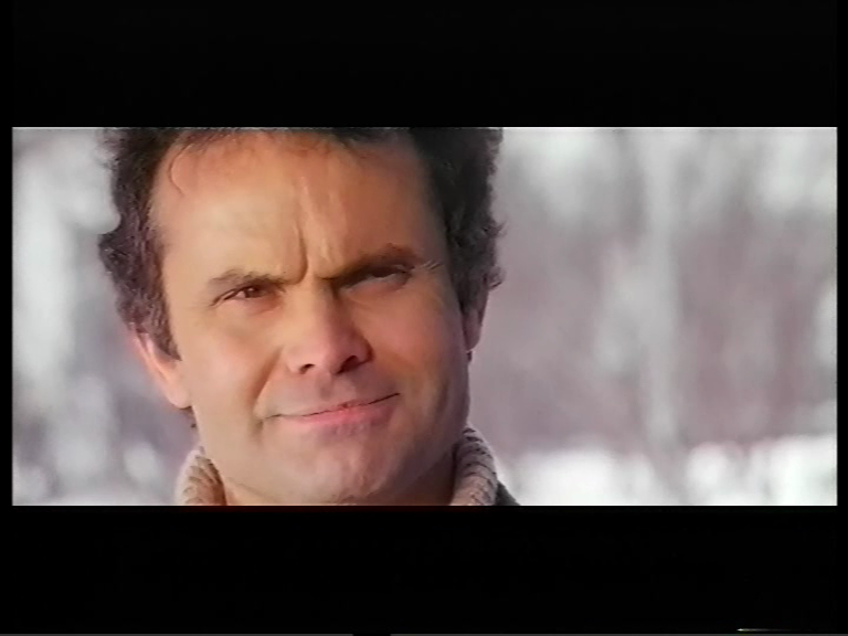

  20. Originally Posted by vaporeon800 View Post

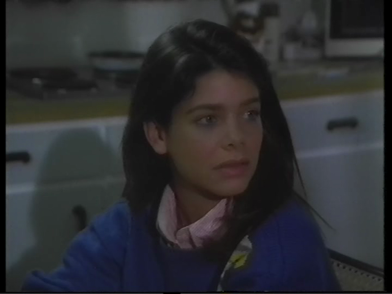

    Yes is the hqdn3d,but i prefer it to a video with noise
    and it work fine on some video,look at this,is not oversmoothed imho
  21. Member PuzZLeR's Avatar
    Oct 2006
    Toronto Canada
    Is that last one from the Mistubishi? Maybe "not oversmoothed", but looks overprocessed. But, I could be wrong because it's only a picture.
    One frame can be deceptive in using it as inference to the quality of the video at large. If you need better advice, you need to post video samples. Capture something raw and post.
    Even so, one tape could look better with your LG and the other can with the Mitsubishi. It's not so straightforward anyway, but we can try.

  22. Originally Posted by PuzZLeR View Post
    Is that last one from the Mistubishi? From this point of view it does look a bit smoothed, or over-processed. But, I could be wrong because it's only a picture.
    Yes is from Mistubishi
  23. Member PuzZLeR's Avatar
    Oct 2006
    Toronto Canada
    It's processed nice and clean, and very similar to what JVC higher end machines do with some tapes. IMO the tapes that works very well with these types of VCRs (Mistubishi high end and JVC high end) are indeed commercial or professional tapes.
    However, I don't like that processed look with EP, or older TV recordings, or similar.

  25. Formerly 'vaporeon800' Brad's Avatar
    Apr 2001
    Vancouver, Canada
    I disagree completely, but it's your video.
