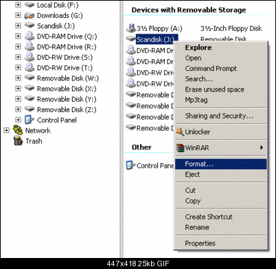

  8. Have you tried right clicking on the drive in question and using Windows to reformat it? I'm assuming the same option is available for newer versions of Windows, but for XP using Windows Explorer:
    You might want to select Properties first to see which file system the drive currently uses. If it's Fat32 you can just reformat it. If it's NTFS and you want to keep it the same, there's a bit of a process in order to format a flash drive as NTFS when running XP. Newer versions of Windows may let you choose either file system without having to go through the following "hassle".
    How do I format a USB Flash Drive to NTFS file system?
    If you format the drive as NTFS using the method in the above link, you can change it back to the "optimise for fast removal" setting when you done if you prefer.
    If you format as fat32 the file size limitation will be around 4GB. If you format as NTFS there's no limitation, but the player may not be able to read it if it's a bit old (all the players in this house read NTFS drives).
    I generally reformat while checking the "quick format" option. If you don't (I assume it applies to flash drives the same as it does to hard drives) Windows will scan the drive and check it for errors while formatting. In your case that might be a good idea, but expect the process to take a fair while.
    If you can't see the drive in My Computer/Windows Explorer, try using Computer Management to see if the drive is listed (see the above link). Drives won't appear in Explorer unless they're formatted. If it appears in Computer Management you can try formatting it from there.
