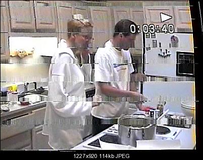

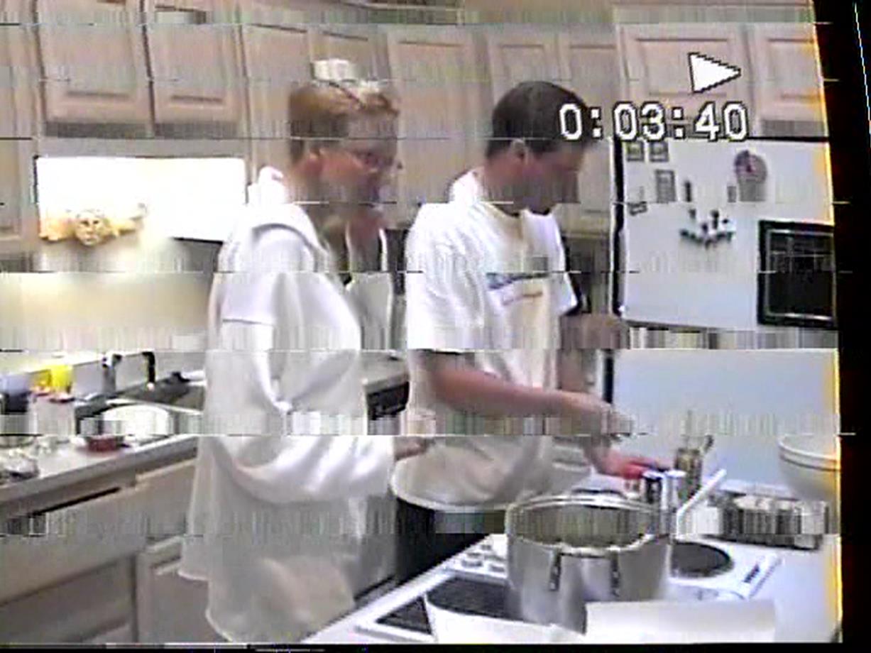

  9. Thank you! I don't know if this will help, but here's a screenshot of what the entire video looks like:
    8 horizontal lines from top to bottom. Slightly wider at bottom and narrowing as you go to the top of the frame. The lines are fixed - they do not move over the course of the video. No sound except occasional pops.

  11. Member Cornucopia's Avatar
    Actually, that's better than what I though it would look like.
    You know, it might be possible to just do a full capture as-is on a regular deck and then run it through AVISynth to do the cleanup.
    Looks like you've got tearing/skew overall, combined with bands (I see 9, not 8) of horizontally displaced sections. If these are static (don't move around during playback either horizontally or vertically) should be a good candidate for fixing. Dynamic changes would make it much harder. I think you were looking at the lines as being the problem. Actually, they are more likely the result of the bands being skewed respective to each other. Or there are 2 separate aspects of the problem.
