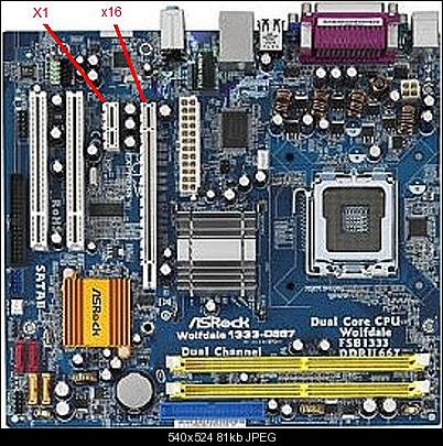

    I have 2 older core2 E2180 computers. I plan to replace one of them with a newer machine but want to keep the second and just add a usb 3.0 x1 io card.
    Here's my problem. The MB has only one x16 pci-e slot, one x1 pci-E slot and 2 regular pci (see attached pic). The x16 slot has a GT 520 Silent video card so I can send a dual signal to a monitor and TV (the mb has only onboard vga) but unfortunately even though the video card is single width the heat sink blades completely cover over the x1 slot too on the inside of the case. I'd like to keep the video card because it lets me play BR discs to a tv connected via hdmi. I've tested the usb 3.0 io card on my 2nd pc which doesn't have a separate video card and it works really well. The difference in speed with usb 2.0 when transferring large video files is quite noticeable. So I hate sacrificing one thing to get the other.
    I checked the distance between the centre of the pci-E slots and it's a measly 3/4 of an inch. What are these MB designers thinking? I have a new micro atx MB sitting in its box on the shelf for a stalled future build and measured the slots on that board and it's the same a mere 3/4" centre to centre. Fortunately that board has a second x1 slot but that's not important here but maybe going too small on a mb is not such a good idea for those with future expansion in mind.
    I'm not a gamer so as long as I can play blu-ray discs via hdcp compatible hdmi I'd be happy.
    The question: Are there any (cheap) pci-e x16 video cards that are no wider than 1/2"?

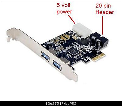

Name:	Syba USB3.0_with_Header 2.JPG

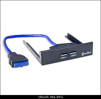

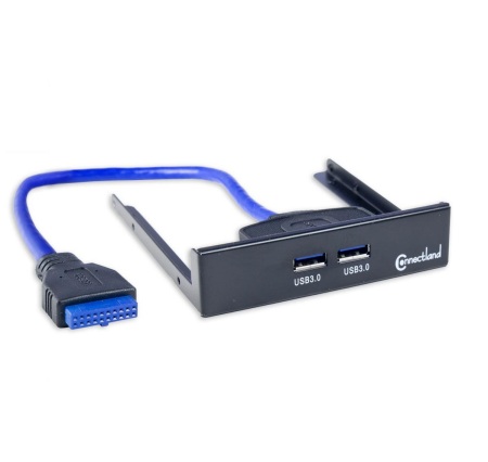

    My plan is to use it with this front plate I already have since I don't want to reach around to plug stuff in or use an extension all the time.
    It fits nicely in the unused 3 1/2" floppy drive bay.

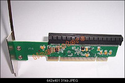

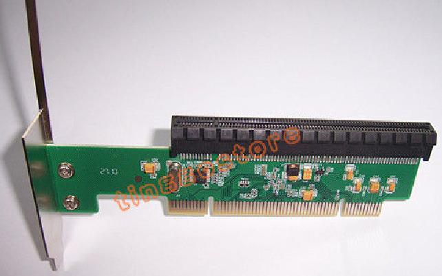

    I looked at buying a standard pci to pci-e x1 or x16 bridge like this for either the usb 3.0 card or my existing video card.
    This is the x16 version
    Again the issue here is speed. I found out that the most I'd get out of the usb 3.0 card is 2 times the usb 2.0 because of the limitations of the standard pci bus. I wasn't sure how the video card would perform if that is what I moved. It wasn't easy to source locally so I dismissed that idea for now.

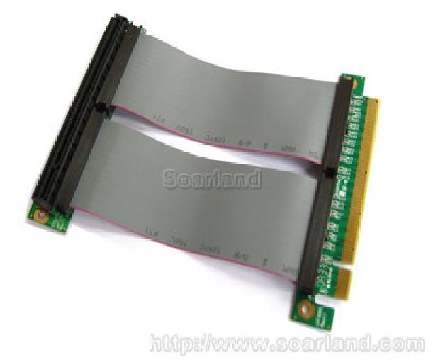

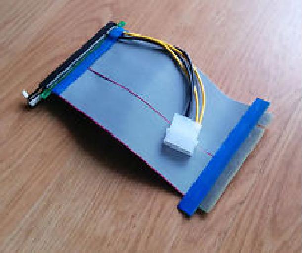

    Another thing I found using good old Google is a riser ribbon
    This allows you to extend your pci-e x16 or x1 slot (They apparently make both types although the pics show the x16) to another location .
Name:	PCI-E x16 riser ribbon.jpg
    or like this
Name:	PCI-E-X16_2_PCI-E-X16 Ribbon Adapter.JPG
    It might work if I could jump the ribbon over the PCI-e 1x slot and line up the video card with an unused pci opening in the back plate.
    I just didn't know if these were really practical for my situation or if I could even make it fit without cutting away the standard pci holder itself to get it out of the way. If the ribbon was really long to clear the MB but not the back plate openings in my case it might work. I haven't got the time to fool around with this but the idea is intriguing.

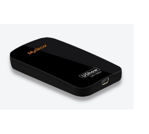

    I tried a $40 (supposedly valued at $80 but some models go much higher) usb to hdmi video output device
Name:	MyGica usb 2.0 to hdmi.jpg
Name:	MyGica usb 2.0 to hdmi 2.jpg
    The quality of the text and video was awful compared to a regular video card. My E2180 was also underpowered for the device so there was lack of smoothness in the video. It played 29.97fps like it was 15 to 18 fps (very unnatural but not the fault of the device). I tested it another much faster PC and it played much smoother but I still wouldn't recommend it to anyone. There is a conversion going on and the output looks worse than a split vga signal. The text showed a lot of jaggies on a 46" tv. I returned it for a refund.

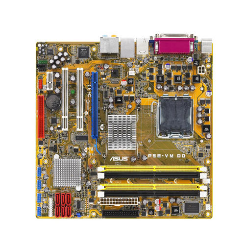

    I still have the pc and mobo referred to in my original question but decided to solve the issue another way. I bought a used Asus P5E-VM DO mb/ E8400 PC for $120 that doesn't have that issue because it has the x16 and x1 slots on opposite sides of 2 pci slots so at worse the video card covers 1 standard pci slot. The case alone is worth as much as I paid and I saved myself a lot of time, frustration and gained a faster PC.
Name:	P5E-VM Do small.jpg
    Note the distance between the 2 pci-e slots (blue = pci-e x16 and small white is the x1)
