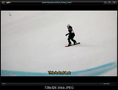

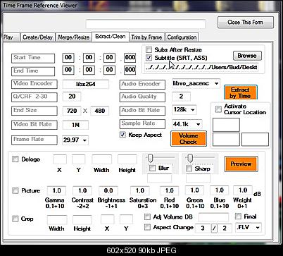

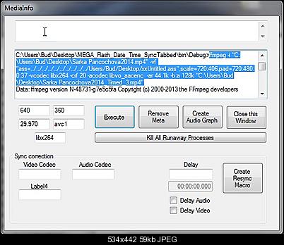

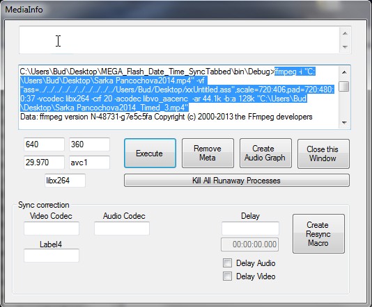

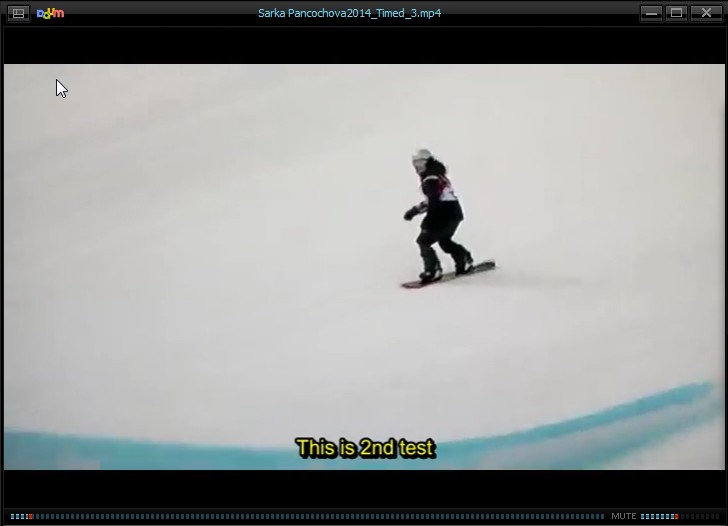

    Here is actual test entry:
Name:	ScreenHunter_65 May. 06 09.07.jpg
    Here is the CLI running:
Name:	ScreenHunter_65 May. 06 09.08.jpg
    And here is the result:
Name:	ScreenHunter_67 May. 06 09.08.jpg
