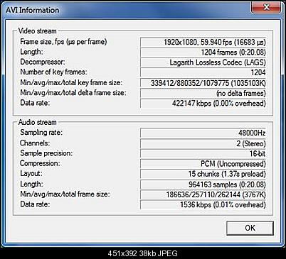

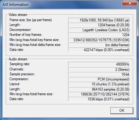

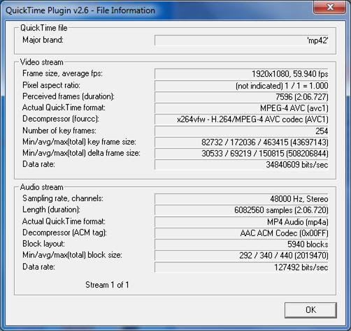

    Just in case it is of any help ...
    here is the file info screen for the original file ...
Name:	file info original.jpg
    and here is the one of the sample created .. that also does not play.

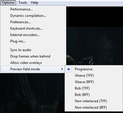

    Slightly improved playback result...
    Audio/Video- > Direct stream copy.
    As predicted problem buffer the audio / video (I now have a stable sound without interruption)
    I hope that to you too can help.

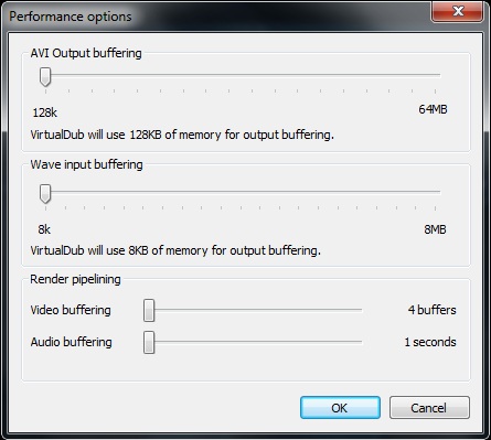

  16. Not sure if I follow this ....

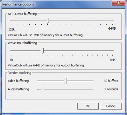

    Current Performance settings are:
    Your settings are reducing these to minimum ..... normally with most applications they run better with more memory & bigger buffers, this seems to be doing the opposite ?
    I did try it ... but it made no difference.

    I achieved on your Semple normal audio playback... ("Drop frames when behind" and "Allow video overlays" - help relieve stress)
    It seems that the decoder works in software mode / strong load on the processor. Plugins act as crutches - need optimization.
    My Win7X64, Core2duo E6600@3.45GHz, DDR3 8GB, Nvidia GT440.

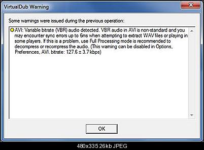

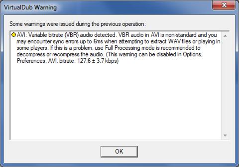

    Not sure if this is of any use ... created 10 sec sample ... using direct stream copy (A&V) and saved as AVI
    When I then load that sample I get following error:

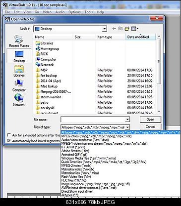

    Are you forcing Virtualdub to use the ffmpeg or DirectShow input drivers by using the "Files of type" pulldown in the Open Video Files dialog? If you don't do that it will use the default AVI input driver.

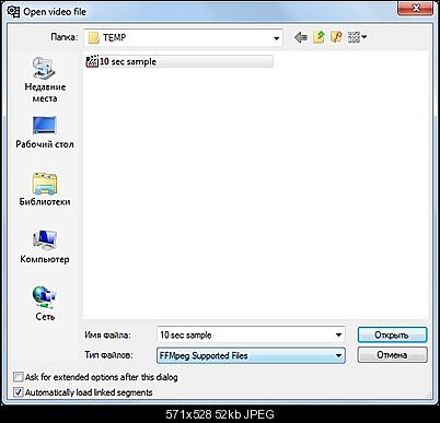

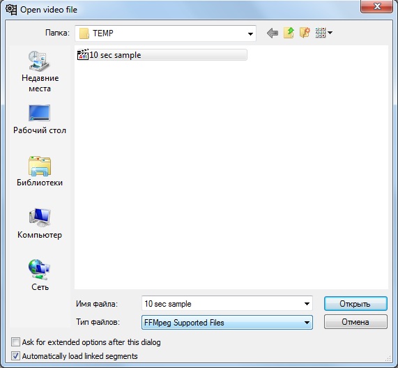

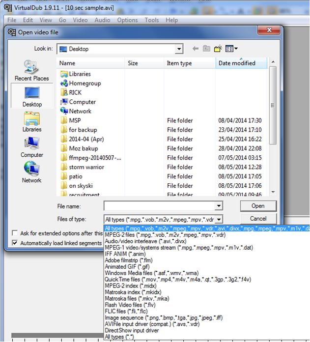

  26. Originally Posted by jagabo View Post
    Are you forcing Virtualdub to use the ffmpeg or DirectShow input drivers by using the "Files of type" pulldown in the Open Video Files dialog?.
    I am just using VD "Open File" ... I don't see option to select " ffmpeg "
    or maybe I'm misunderstanding ... this is what I see:
    I do have FFinput driver plugin and ffdlls folder installed.

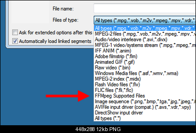

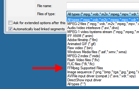

  27. If the ffmpeg source plugin is properly installed you should see "ffmpeg supported files" in that list:
    ffInputDriver.vdplugin should be in VirtualDub's plugins32 folder. So should the ffdlls folder and its contents.
    Make sure you aren't mixing 32 bit and 64 bit components. Ie, use only 32 bit filters with 32 bit VirtualDub. Only 64 bit filters with 64 bit VirtualDub.

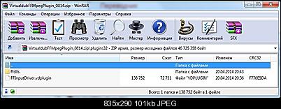

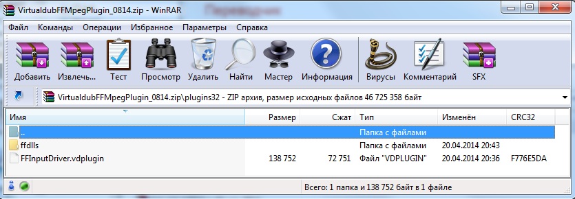

    first download > FFmpegPlugin
    Open the package with the contents of the folder plugins32

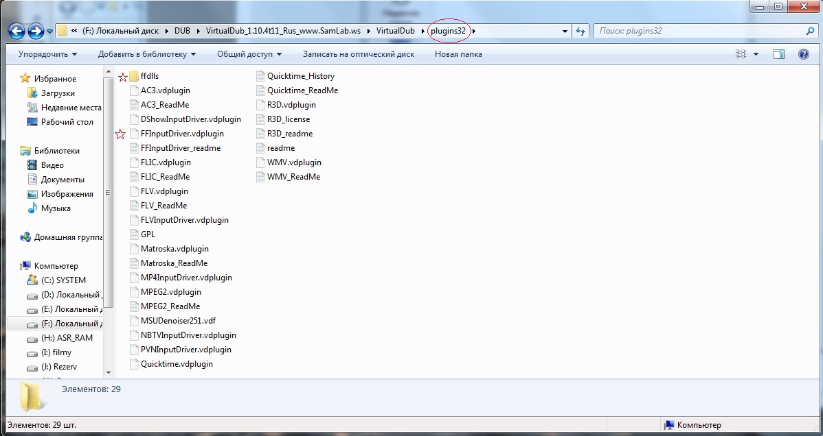

    Go to the folder X:\VirtualDub\plugins32 > and copy the files in this folder
