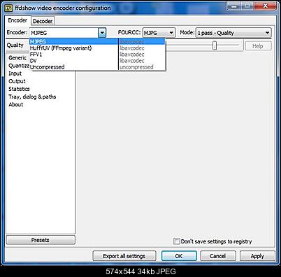

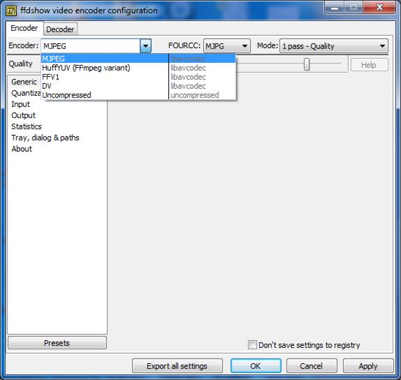

  21. well until I put it there ... VD was complaining that there was missing file on start up, but stopped complaining when I put folder there.
    Still have the problem that Video plays ... but audio is pulsing ... less that 1 sec burst of audio every second ...
    I have installed the plugins .... the bit I think I'm missing was the comment :
    Install ffdshow and under VFW configuration, set libavcodec for H.264/AVC. You can set any other file type to libavcodec that you wish (I like to use the stand alone encoders myself) and set Windows Media Files 1/7, 2/8 and 3/9 to wmv9 and vc1 to libavcodec.
    I am not sure what/how to do that .... opening VFW shows codecs but not H.264/AVC:
  22. Member
    Nov 2002
    Originally Posted by Tafflad View Post
    The FFMEG plug in download includes a folder of DLL's but no instructions regarding them ... can you advise where (if) I need to put these in a specific location.
    I am using VD 32 bit on W7.
    EDIT- I tried in VD folder and it complained on start up for FFDLLS ... tried putting complete folder in Plugins folder and it seems happy
    Unzip the downloaded file with 7zip and there are two folders, 32 bit and 64 bit. Open the 32 bit folder and copy the files to your plugins 32 folder in Virtualdub.
  23. Member
    Nov 2002
    [Attachment 24978 - Click to enlarge]
    You're looking at the encoders tab. Switch it to the Decoders tab.
