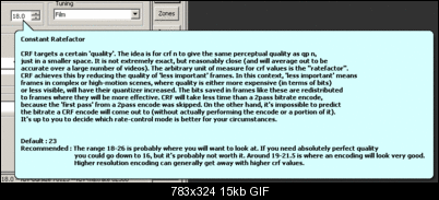

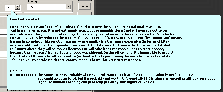

  26. As far as x264 settings go, the Vidcoder High Profile preset uses the defaults. Most people use CRF (quality based) encoding. Pick a CRF value which gives you the quality you're happy with and you can just use it all the time. I use CRF18 for video up to and including 720p (most of the time). For 1080p I use CRF20 to help keep the file size down a bit. It's all personal preference. Here's a screenshot of MeGUI's tooltip (so I don't have to type it).

    Once you've settled on a CRF value, pick an appropriate tuning (none, film, grain etc) and use the slowest speed preset you can stand. I generally use either medium or slow myself. There's not really anything else to worry about.
