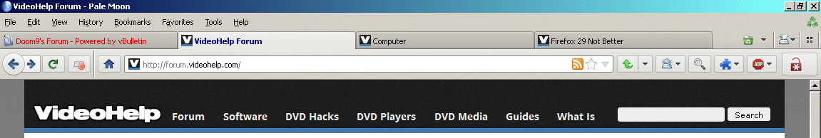

  9. I finally got around to trying Pale Moon today. Aside from having to select the "tabs on top" option (because I'm used to having them there and I do think it's a better place for them), I just copied my Firefox profile and mostly, everything worked. All my Firefox extensions are working with the exception of URL Suffix. Pale Moon says it's not compatible with the current version of the browser, but it's compatible with Firefox 28. I'll try to fix that later. LastPass works. I was most concerned about that one. So far the only other thing I've needed to do is add an "open tabs" icon to the tab bar, because TabMixPlus's "open tabs arrow" doesn't seem to work.
    TreeTops,
    If you want to try again, here's what I did. I downloaded the portable version of Pale Moon, unzipped it and ran it. Then I shut it down and had a look for the location of the default profiles folder. Being a portable version the profile seems to be kept in a subfolder of wherever you put Pale Moon (ie PaleMoon\User\Palemoon\Profiles\Default). You should be able to delete everything in the "Default" profile folder, replace it's contents with a copy of your Firefox profile, and you should be good to go.
    In my case I put the copy of the Firefox folder in the same folder as I put most of my other data files. To tell Pale Moon where to find the profile folder (I'm referring to the the portable version of Pale Moon as the "installed" version probably does it differently), you need to open the "Palemoon-Portable.ini" file with notepad. Inside it you'll find the following lines:
    [FileToRun]
    PathToExe=$Bin$\$AppName$\$AppName$.exe
    Parameters=-profile "%MOZ_PROFILE_PATH%"
    All you need to do is change the third line to reflect the location of the profiles folder (assuming you didn't leave it in it's default location) and everything works fine. In my case I changed it like this:
    [FileToRun]
    Parameters=-profile "D:\My Stuff\Data Files\Pale Moon"
    I wasn't looking forward to upgrading to Firefox 29. I figured I'd probably need to spend time getting Firefox 28 functionality back, and if I wanted to use a browser which looks like Chrome, I could use it instead. Now I don't need to worry as it seems I'm no longer a Firefox user. For me, Pale Moon and Firefox 28 look virtually identical and pretty much everything seems to be working as it was previously.
    Firefox 28:
    Pale Moon:
