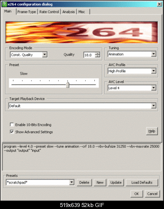

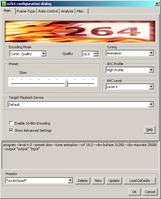

    What you have there appears to be the x264 slow speed preset with the animation tuning and High Profile, Level 4.0, or something very close to it:
    Video
    Format : AVC
    Format profile : High@L4.0
    Format settings, CABAC : Yes
    Format settings, ReFrames : 10 frames
    Codec ID : V_MPEG4/ISO/AVC
    Width : 496 pixels
    Height : 272 pixels
    Display aspect ratio : 1.85:1
    Frame rate mode : Constant
    Frame rate : 25.000 fps
    Color space : YUV
    Chroma subsampling : 4:2:0
    Bit depth : 8 bits
    Scan type : Progressive
    Writing library : x264 core 142 r2409 d6b4e63
    Encoding settings : cabac=1 / ref=10 / deblock=1:1:1 / analyse=0x3:0x113 / me=umh / subme=8 / psy=1 / psy_rd=0.40:0.00 / mixed_ref=1 / me_range=16 / chroma_me=1 / trellis=1 / 8x8dct=1 / cqm=0 / deadzone=21,11 / fast_pskip=1 / chroma_qp_offset=-2 / threads=6 / lookahead_threads=1 / sliced_threads=0 / nr=0 / decimate=1 / interlaced=0 / bluray_compat=0 / constrained_intra=0 / bframes=5 / b_pyramid=2 / b_adapt=2 / b_bias=0 / direct=3 / weightb=1 / open_gop=0 / weightp=2 / keyint=250 / keyint_min=25 / scenecut=40 / intra_refresh=0 / rc_lookahead=50 / rc=crf / mbtree=1 / crf=18.0 / qcomp=0.60 / qpmin=0 / qpmax=69 / qpstep=4 / vbv_maxrate=25000 / vbv_bufsize=31250 / crf_max=0.0 / nal_hrd=none / filler=0 / ip_ratio=1.40 / aq=1:0.60
    Language : English
    The above was using quality based encoding (CRF18) so there's a difference there (your video was encoded while specifying a bitrate for 2 pass encoding), and mine was a low resolution encode, which means the number of ref frames are higher than if it'd been 1080p, but loading the defaults, then configuring the x264 encoder like this gave me the above settings. I didn't touch any of the advanced options.

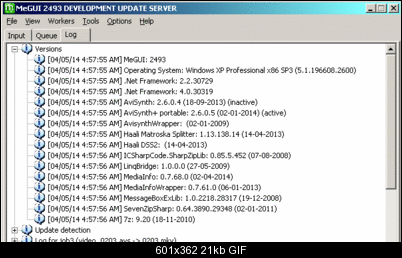

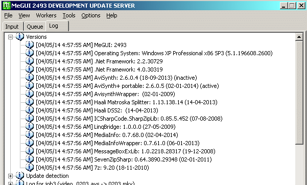

    Originally Posted by supercain View Post
    By the way, i just checked and i still have megui. However, i still have the same issue. I dont have any preview window. Why is it that? Is there any place where i must activate it or something?
    I can't say I've come across anyone else with that problem. How old is the version you're using? Is it giving you an error? It might be an Avisynth issue, but I'd just delete/uninstall it and download the latest version. I don't think there's no installer anymore. You just unzip it, put it somewhere, run MeGUI and then the updater under the Options menu. Let it do it's thing and you should be good to go. The only third party application you need installed for some decoding is the Haali Media Splitter.... and I think MeGUI requires a minimum of dot net framework 2 to work (maybe that's the problem?) but unless you're running XP you'll definitely have that. It comes with a portable version of Avisynth so you don't need to install it separately. The only other thing required is the NeroAAC encoder which is easy to download if you want AAC audio encoding, then NeroAAC can be enabled in MeGUI's options. All you need to do is copy NeroAAC.exe to the following MeGUI folder: "MeGUI\tools\eac3to"
    When you first run MeGUI you can switch to the Log tab and look under "Versions". If there's any important bits missing/not installed, it'll tell you there.

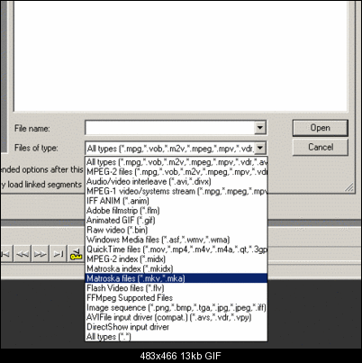

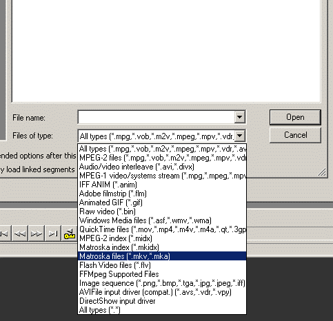

  20. Originally Posted by DarrellS View Post
    Hmm no, on virtualdub you cant direct stream copy videos such as mp4 or mkv, only avi.
    That is strange since I just direct stream copied a AVC.mkv into a AVC.avi.
    Yes you can with the mkv import plugin. You can't with the DirectShow plugin and FFInputDriver because they are decoded to uncompressed
    But it's not very useful - because editing natively with direct stream copy of AVC in vdub isn't reliable - you will often get glitches, green frames, or the wrong frame/ frames out of order - even if you attempt to cut on keyframes
    Theoretically , if you used AVC without b-frames, or even I-frame only, you shouldn't get those issues. But I-frame AVC even has those issues in vdub for some reason
  21. Originally Posted by poisondeathray View Post
    I thought about that after I posted. It also goes for avisynth which is why it is better to always use the correct codecs when you can instead of taking the lazy route and installing one plugin hoping it will work for all your files. Even with the input plugins you still need to depend on ffdshow to help open certain files.
    I know it's not wise to put avc in avi container but for trying to append multiple files together for editing, it is a work around. Using mkvmerge to append is probably a better option though. I hardly ever get mymp4box or Yamb to work correctly. AVC is a finished product though and not meant to be edited. Even the best editors will choke on avc at times.

  24. Thats weird, i have the plugin that opens mkvs but even with that, i cant save them as direct stream copy. Why? Do i need another plugin?
    Aslo, i kinda found a solution for my problem. In fact i just recalled what i had already done before in these situations. Since i have to encode anyway, i encode part 1 and 2 separately, and since they are going to be encoded with exactly the same settings then i can join them with direct stream copy. I just would like to be able to use the external encoders feature so i can save to mp4 instead.
  25. I tried opening an MP4 using the Quicktime plugin and VirtualDub resaved the output as an AVI using direct stream copy without any problem. The Matroksa plugin did the same for an MKV.
    Try the Quicktime and Matroska plugins on this page (the fccHandler versions). When you open a file, make sure you specifically choose the correct plugin. VirutlaDub may be opening the video using the wrong plugin by default.

    I've never had to use the "open with "Matroaska files"". You do need to have the mkv input plugin and ffdshow vfw set to open h264/avc with libavcodec.
