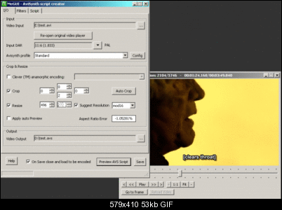

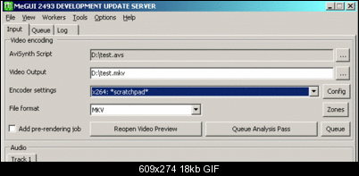

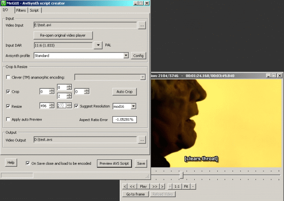

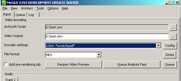

  9. I'd do it with MeGUI, but it'd involve a bit of Avisynth knowledge in order to join files together and/or edit.
    If you're comfortable with VirtualDub, the latest version has an option for setting up an external encoder configuration. It's a pain, but once you get it working you can output x264/MKV etc. Alternatively.... do everything you'd normally do using VirtualDub and save the output as a lossless AVI. That way you won't lose any quality while editing and re-encoding. Lagarith is a quite popular lossless encoder. The output file size will be fairly large, but when you're done you can re-encode the lossless AVI with any GUI capable of x264 encoding. If you output several AVIs you can open and append them with either VirtualDub or MKVMergeGUI and save the output as a single AVI/MKV for re-encoding.
    If you re-encode with x264 and it's single pass, quality based encoding method, a quality setting (CRF value) of 18 should be pretty transparent. If you want absolute perfection, you could take the CRF value down as low as 16, but naturally it'll increase the output file size.

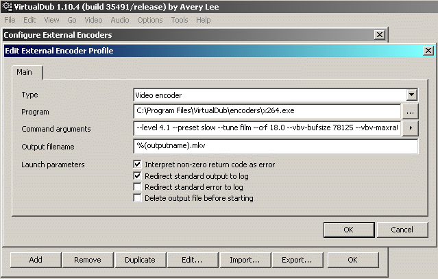

    It took me a while to get it working the first time but I really only set it up as an exercise. I don't use VirtualDub for encoding (except to a lossless AVI).
    The option is under Options/External Encoders.
    If it helps get you started, this is the x264 commandline I used which seems to work. It's been a while but I think all the settings in blue are VirtualDub options and required. The ones in black are the extra x264 encoder settings I use. You'll need --stitchable if you're planning on appending encodes later.
    --level 4.1 --preset slow --tune film --crf 18.0 --vbv-bufsize 78125 --vbv-maxrate 62500 --stitchable --demuxer raw --input-csp i420 --input-res %(width)x%(height) --fps %(fpsnum)/%(fpsden) -o "%(tempvideofile)" -
    Once you've set up an encoder profile, it needs to be added as an "encoder set" in order to use it. It took me a little while to work that one out.

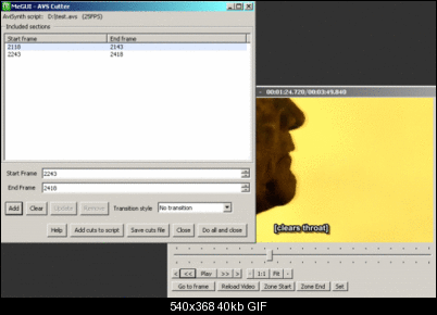

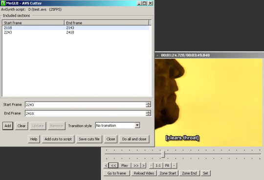

    MeGUI can edit video when encoding but it does it via Avisynth scripts. It has an AVS Cutter under the Tools menu. If you want to encode parts of a video you can open it with MeGUI and it'll help you create a script (cropping, resizing, hardcoded subtitles etc etc) and then it'll save the script for encoding. That's how you'd normally set up an encode, but you can open the script with the AVS Cutter and specify multiple start and end frames for encoding. When you're done you'll be encoding just the bits you want. It's really no different to editing with VirtualDub in that respect. The audio is handled separately but the AVS Cutter can save a file to load into the audio section so it can be encoded to match. Or there's an Audio Cutter under the tools menu which will split and rejoin the audio without re-encoding it.
    Mostly if I want to combine different videos as a single file I encode them individually and append the encodes together with MKVMergeGUI, but you can combine multiple scripts as single encoding job, as long as they created with the same resolution etc... you just need to do that part "manually".

  17. Hmm, i dont know what im doing wrong. Im positive im copy-pasting the command as you posted but still no use. I even got virtual dub 64 bit version and i got the same error. This is what i did step by step:
    1. I went to external encoders and on the encoders tab i created a new profile like this:
    -Type: Video encoder.
    -Program: The exact location of the one i posted above
    -Command arguments: --level 4.1 --preset slow --tune film --crf 18.--level 4.1 --preset slow --tune film --crf 18.0 --vbv-bufsize 78125 --vbv-maxrate 62500 --no-fast-pskip --stitchable --demuxer raw --input-csp i420 --input-res %(width)x%(height) --fps %(fpsnum)/%(fpsden) -o "%(tempvideofile)" -
    -Output filename: %(outputname).mp4
    And i checked the first 3 checkboxes then OK.
    2. I went to encoder sets and i created a new profile like this:
    -Video encoder: the one i just created above.
    -Audio encoder: I dont need one right now so i set it to none
    -Multiplexer: none
    -File extension: mp4
    Then OK.
    3. I went to file -> Export -> Using external encoder and selected the one i just created.
    After that the output window appears but immediately after that i get the error i posted above. Really there is not much else to say.
    Thank you for your patience.

    I'm fairly sure the x264 encoder can't output directly to MP4. At least not the standard commandline version. There may be a modded version which can.
    It doesn't seem to make any difference which extension you use when setting up the x264 encoder profile, but if you use MP4 when adding it to an encoder set..... well it produced the same error when I tried it. If you're keen on MP4 you'd need to either add an external muxer to an encoder set (which I haven't tried myself), or use 264 as the extension, then mux the output into an MP4 yourself with something like MyMP4BoxGUI.
    If there's a version of the x264 encoder which can output directly to MP4, someone else will hopefully know. There definitely was at some stage because MeGUI was able to do it. The option was removed a while ago.... the entry in MeGUI's log file says:
    [x264] disabled direct mp4 output as the official builds do not have this support enabled anymore

  30. Editing in MeGUI isn't the same as VirtualDub, but at the same time, it's a lot like it. You don't really need to understand Avisynth, but with a little knowledge you can start playing around with modifying scripts and manually adding different filters/plugins etc, but for straight editing and re-encoding.....
    You seem to know your way around an encoding program well enough to wrap your brain around using MeGUI without your head exploding
    First you open a file with MeGUI (File/Open menu) and let it index it, then help you create the script (it's often a good idea to remux MP4s and AVIs as MKVs first, then open the MKVs for encoding as MeGUI can extract the audio from MKVs). There's nothing out of the ordinary there. Crop and resize etc with a preview. Subtitles are added for hardcoding under the Filters tab.
    You save the script and use the script cutter to open it and set start and end points for encoding, pretty much like you would with VirtualDub, but without banging your head against the desk because it's not navigating frame-accurately.
    It'll save a "cuts file" to load into the audio section so the audio will be re-encoded to match, or you can use the Audio Cutter under the tools menu if you don't want to re-encode.
    Use the Config button to configure the video encoder, then add the encoding job to the queue and run it.
    Once it's done you can append the output files with MKVMergeGUI or MP4Box etc.
