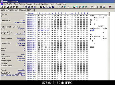

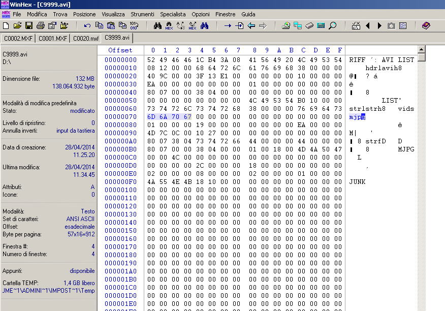

  5. kindly I should have another question:
    considering my .avi file Click image for larger version
ID:	24859 I would like to change mjpg in MJPG
    can I do this directly from dos-command? of course I think the avi file have to be rewrite but what is the command to do this? thank you

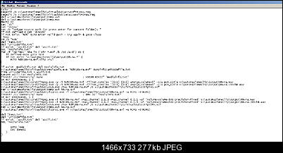

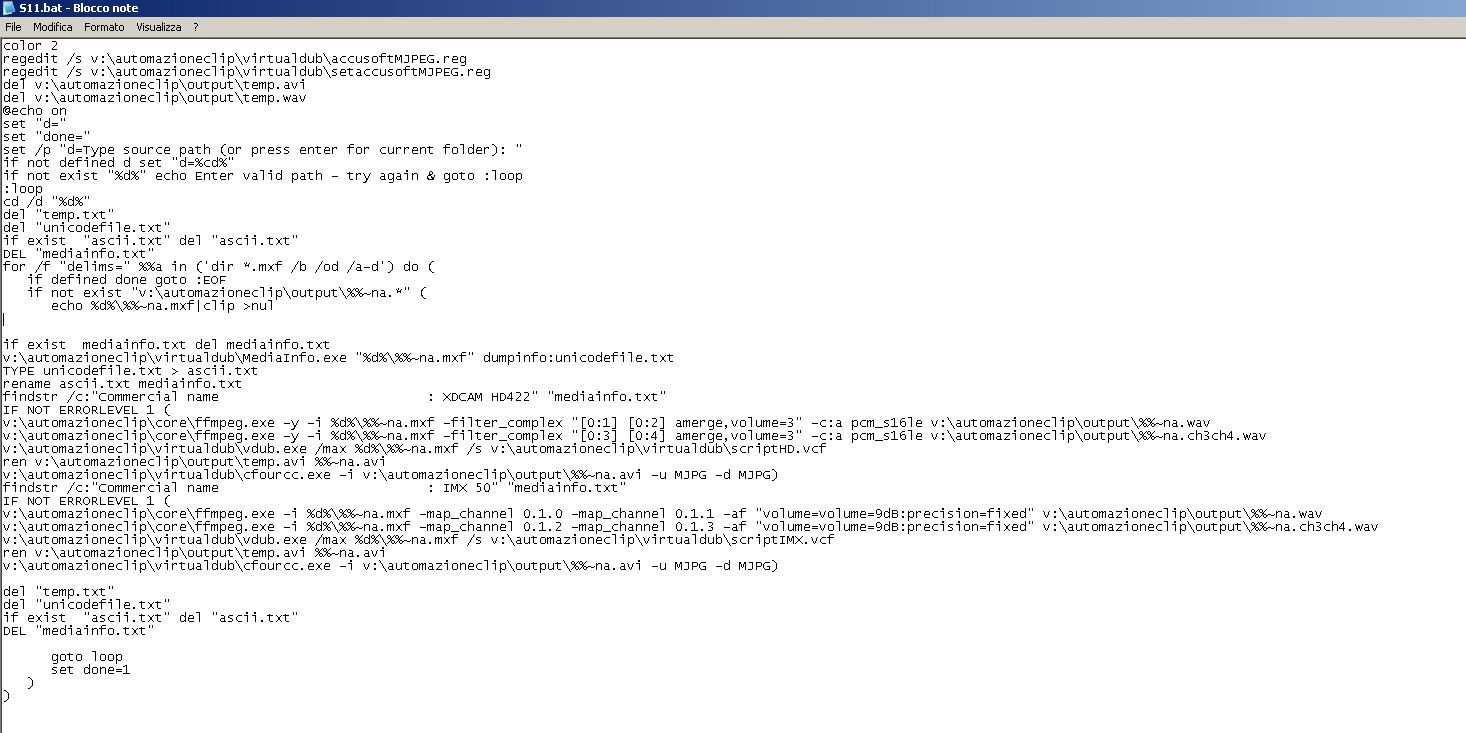

  6. color 2
    regedit /s v:\automazioneclip\virtualdub\accusoftMJPEG.reg
    regedit /s v:\automazioneclip\virtualdub\setaccusoftMJPEG.reg
    del v:\automazioneclip\output\temp.avi
    del v:\automazioneclip\output\temp.wav
    @echo on
    set "d="
    set "done="
    set /p "d=Type source path (or press enter for current folder): "
    if not defined d set "d=%cd%"
    if not exist "%d%" echo Enter valid path - try again & goto :loop
    :loop
    cd /d "%d%"
    del "temp.txt"
    del "unicodefile.txt"
    if exist "ascii.txt" del "ascii.txt"
    DEL "mediainfo.txt"
    for /f "delims=" %%a in ('dir *.mxf /b /od /a-d') do (
    if defined done goto :EOF
    if not exist "v:\automazioneclip\output\%%~na.*" (
    echo %d%\%%~na.mxf|clip >nul
    if exist mediainfo.txt del mediainfo.txt
    v:\automazioneclip\virtualdub\MediaInfo.exe "%d%\%%~na.mxf" dumpinfo:unicodefile.txt
    TYPE unicodefile.txt > ascii.txt
    rename ascii.txt mediainfo.txt
    findstr /c:"Commercial name : XDCAM HD422" "mediainfo.txt"
    IF NOT ERRORLEVEL 1 (
    v:\automazioneclip\core\ffmpeg.exe -y -i %d%\%%~na.mxf -filter_complex "[0:1] [0:2] amerge,volume=3" -c:a pcm_s16le v:\automazioneclip\output\%%~na.wav
    v:\automazioneclip\core\ffmpeg.exe -y -i %d%\%%~na.mxf -filter_complex "[0:3] [0:4] amerge,volume=3" -c:a pcm_s16le v:\automazioneclip\output\%%~na.ch3ch4.wav
    v:\automazioneclip\virtualdub\vdub.exe /max %d%\%%~na.mxf /s v:\automazioneclip\virtualdub\scriptHD.vcf
    ren v:\automazioneclip\output\temp.avi %%~na.avi)
    findstr /c:"Commercial name : IMX 50" "mediainfo.txt"
    v:\automazioneclip\core\ffmpeg.exe -i %d%\%%~na.mxf -map_channel 0.1.0 -map_channel 0.1.1 -af "volume=volume=9dBrecision=fixed" v:\automazioneclip\output\%%~na.wav
    v:\automazioneclip\core\ffmpeg.exe -i %d%\%%~na.mxf -map_channel 0.1.2 -map_channel 0.1.3 -af "volume=volume=9dBrecision=fixed" v:\automazioneclip\output\%%~na.ch3ch4.wav
    v:\automazioneclip\virtualdub\vdub.exe /max %d%\%%~na.mxf /s v:\automazioneclip\virtualdub\scriptIMX.vcf
    del "temp.txt"
    DEL "mediainfo.txt"
    goto loop
    set done=1
