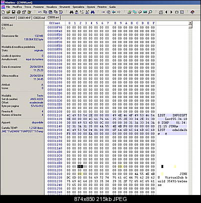

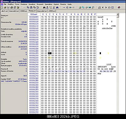

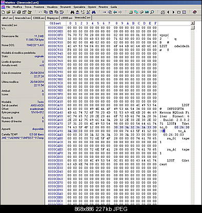

    to save time and not having to re-encode it again with the procedure kindly suggested (and correct functioning) by poison using ffmpeg
    I supposed to be a cats play but it's very very difficult, almost impossible to add a initial timecode code into a virtualdub mjpeg .avi file...
    I have see in another case (ffmpeg, matrox digisuite .avi files ecc..) timecode code in "envelope" in the header of the .avi, I thought that somehow, using hex editor you could (in an automated way then) enter the timecode but now I have lost hope

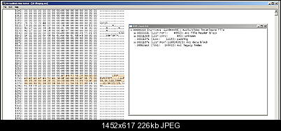

ID:	24810Click image for larger version

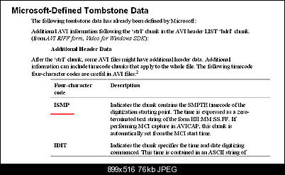

  4. Member Budman1's Avatar
    Jul 2012
    NORTHWEST ILLINOIS, USA

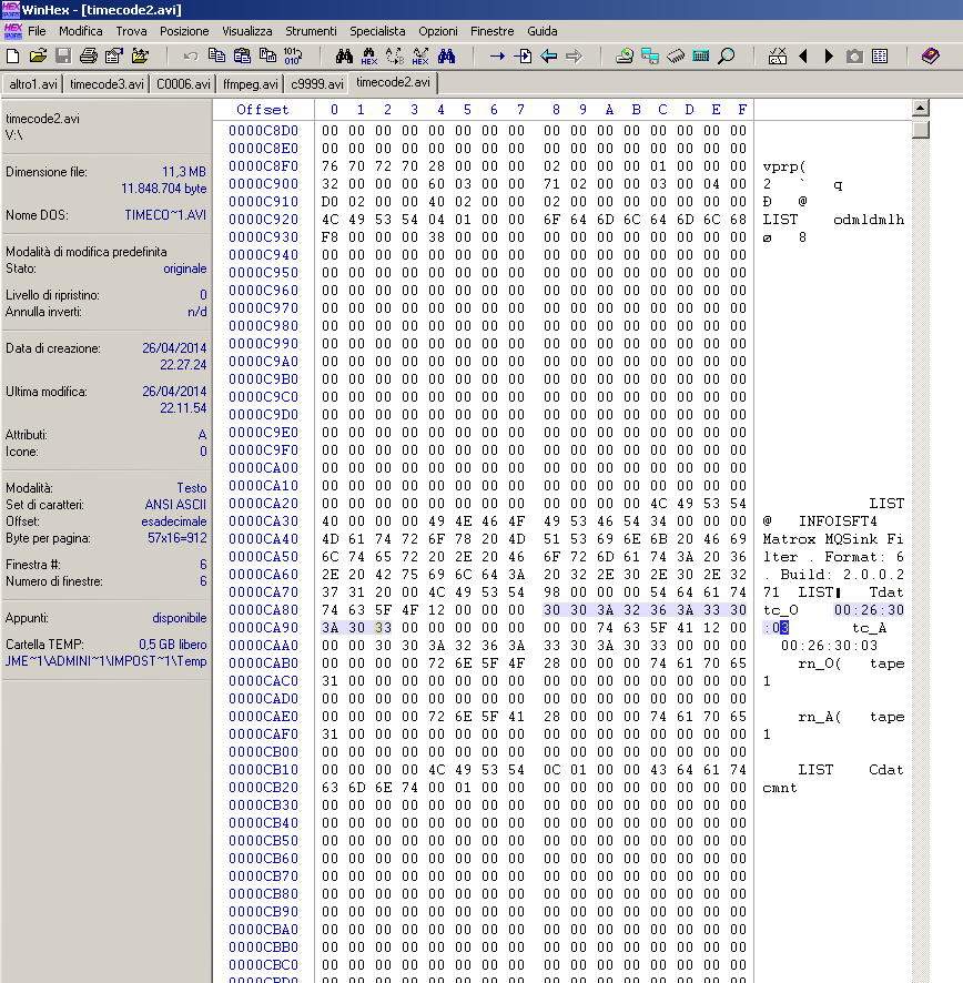

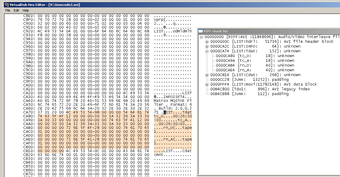

    It cannot be done easily because each 'chunk' of the AVI has a byte count (4 bytes) following the chunk name. To make it even worse, some chunks have a major chunk that encompasses several others and the byte count for it includes the sub chunks. Notice 'tdat' chunk including 'tc_0', 'tc_a', 'rn_0' and 'rn_a'. This is similar to MP4 file 'Atoms' structure.
    If the correct chunk (ISMP) was included and you just wanted to CHANGE the date/time then yes, it could be done, but if you are trying to add it, the whole file would need rewritten, at least the byte counts and that would be easier to have an existing program do that for you.

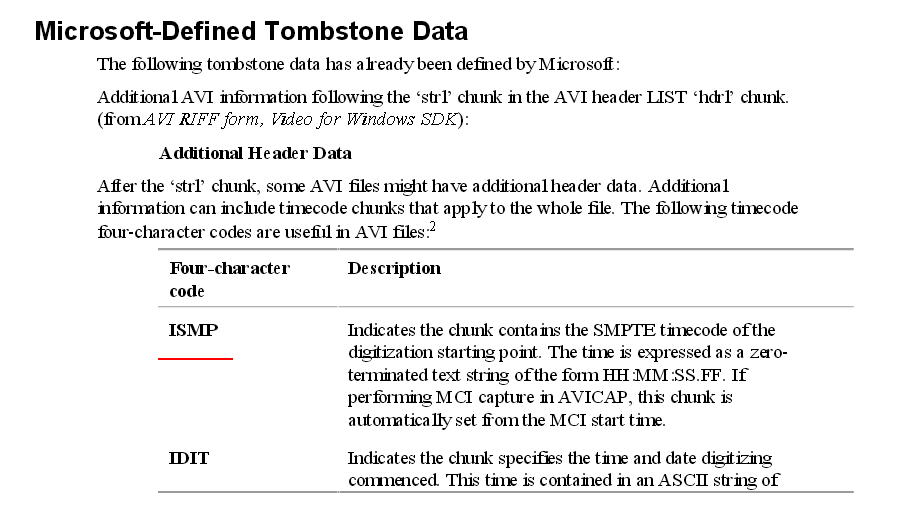

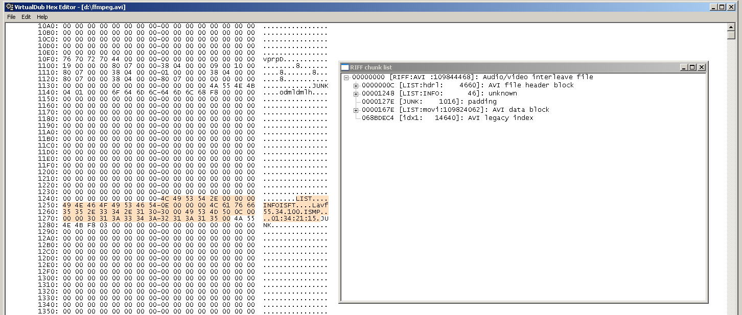

  11. To add ISMP or IDIT chunks you might be able to overwrite the JUNK chunk (it's just padding to align later chunks on 1K or 4K boundaries) that usually follows the STRL chunk. Rename the chunk ISMP, leave the length intact, write the date/time data in the body of the chunk. Since ISMP and IDIT are null terminated ascii strings it shouldn't matter that there's a lot of extra nulls following the date/time. I don't know what programs report that data so I can't test it.

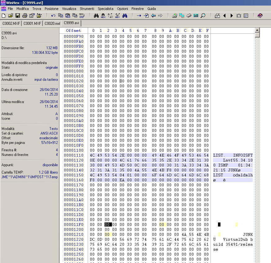

  13. Originally Posted by jagabo View Post

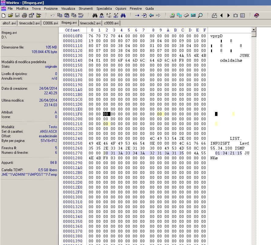

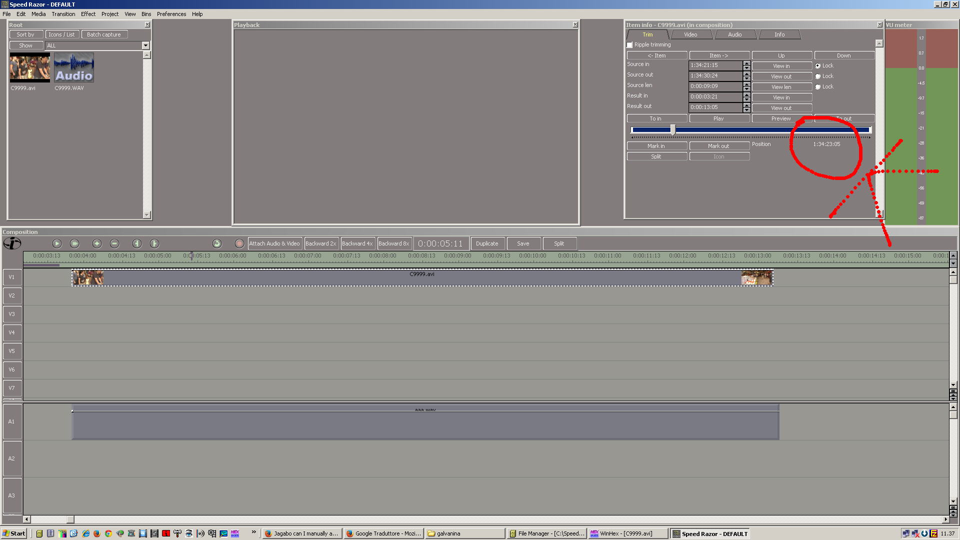

    yes : it seems workName:  CT5.jpg
    at least in the abstract and in the files that I've changed, it works.
    It is about whether the procedure is automated in batch and if it takes longer than the procedure of rewriting with ffmpeg

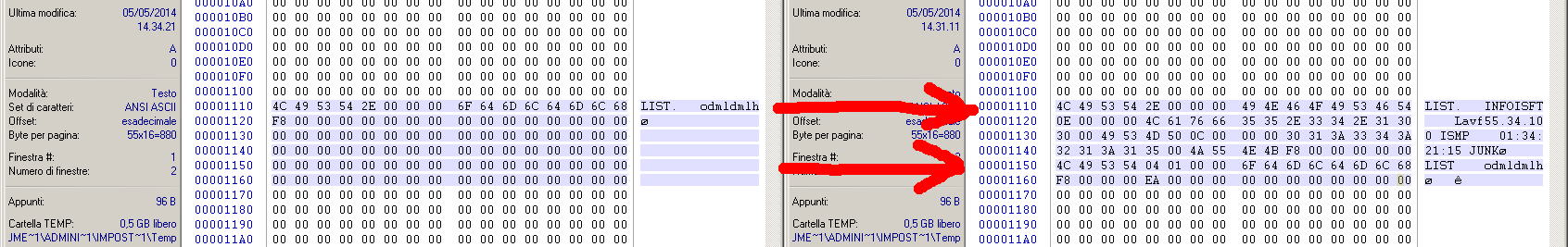

  14. Hi again, so now with this enhancement I can add timecode to a .avi file
    can I found a dos program that can change hex values so this, in a .avi file?
    I'm looking for an application that can change the .avi header, possibly without rewrite the entire .avi file? and possibly I would like copy the timecode data from a file and put to the destination file
