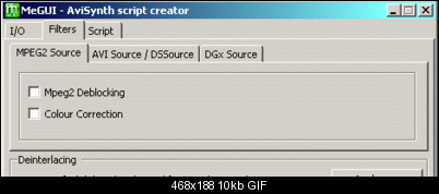

  5. You don't need to use ColorMatrix. It won't be doing anything. I don't know why it's still enabled by default in MeGUI. It doesn't do anything when converting DVDs.
    You've also got the mpeg2 deblocking enabled. It's very mild, but it can blur a bit. Disable it unless you know you need it.
    Try leaving these two unchecked:

    Why did you delete the first sample? I was going to analyse it with MeGUI myself to see if I got the same result. You realise you can attach a sample to a post here? No need to upload it somewhere else.
    There's no way MeGUI will analyse the second one and get the de-interlacing correct. I'm not sure if there's any encoder GUIs that would. Oddly enough, that's the second DVD of that type I've come across this week and I live in PAL-land and haven't re-encoded any DVDs for a while. Strange..... the other one I came across like that a few days ago was a BBC series.
    Someone who knows better may be able to correct me, but your second sample seems to have started off life as PAL, it was slowed down a tiny bit, resized to NTSC and changed to an NTSC frame rate using pulldown. I'd convert it like this (I probably would enable deblocking for that one):

    It's definitely progressive. I don't know why MeGUI thought it was interlaced. When I tried analysing the sample it failed. I'm not sure why. Maybe the fact there's more black than picture is confusing the issue.
