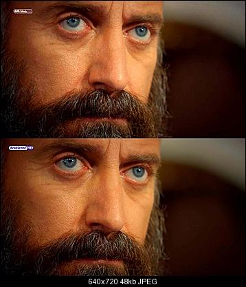

  2. You like orange faces, do you?
  3. Tweak is a built-in avisynth function which can be used to adjust the saturation, contrast, and brightness.
    http://avisynth.nl/index.php/Tweak
    Tweak(sat=1.0, cont=1.0, bright=0.0, coring=false)
    Put the above at the end of a script and adjust the values to taste.
    ColorYUV can adjust the gamma, amongst other things,
    http://avisynth.org.ru/docs/english/corefilters/coloryuv.htm
  4. Originally Posted by manono View Post
    I thought the same thing. The "A" pics could maybe use a bit of a tweak, but the "B" pics are horribly over-done.
  5. That's insane. But if you really must, this is about right in AviSynth:
    Tweak(cont=1.5, bright=-23, sat=1.9)
    ColorMatrix("rec.709->rec.601")
    no I don't like the orange faces but I want to know the man who encoding the video how he do it
    Thank you, I know how to use the filters but the problem that I didn't know how to make the video same pics B
    thank you for your help, I know that's insane but it's just a curiosity to encode videos same pics B
    any way I have try the filter settings you put it above, but unfortunately the result not same pics B
  7. Originally Posted by JoJoJoJo View Post

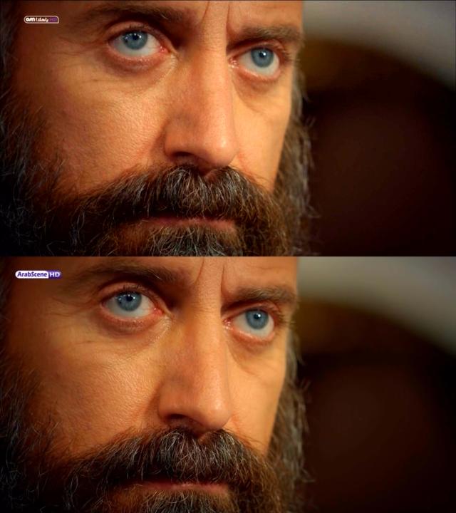

    They look pretty close to me:
    You can tweak them to perfection yourself. I'm not going to spend my time on your job.
    [Attachment 24807 - Click to enlarge]
    okay sir thank you so much and i'm sorry to spend your time, I will tweak them
