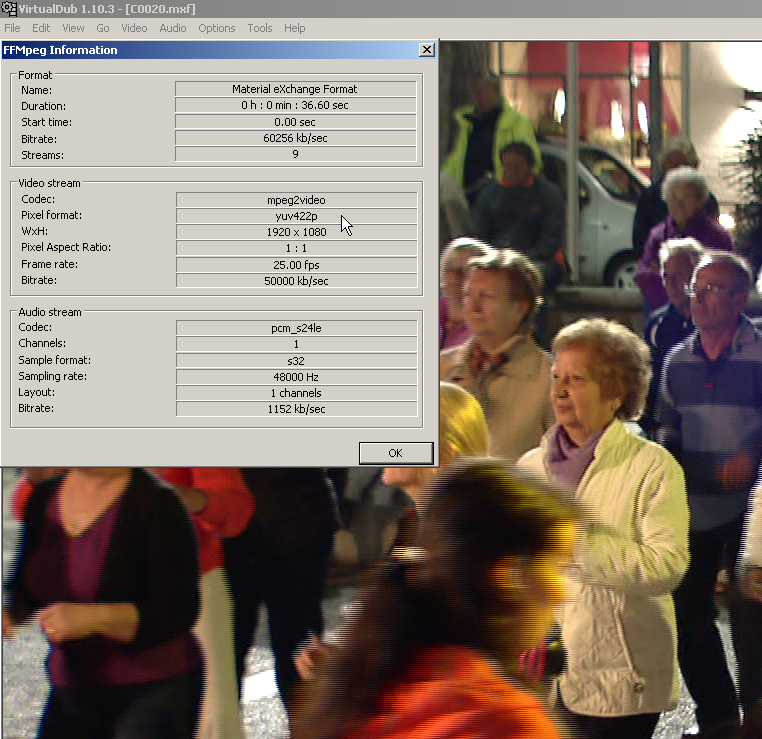

  10. Member racer-x's Avatar
    Mar 2003
    3rd Rock from the Sun
    Why not import the mxf file into Virtualdub via FFInputDriver, it keeps 4:2:2. Do what you have to do, then export to mjpg or whatever.
