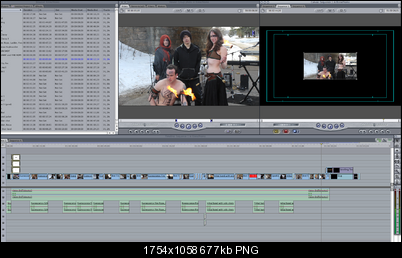

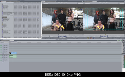

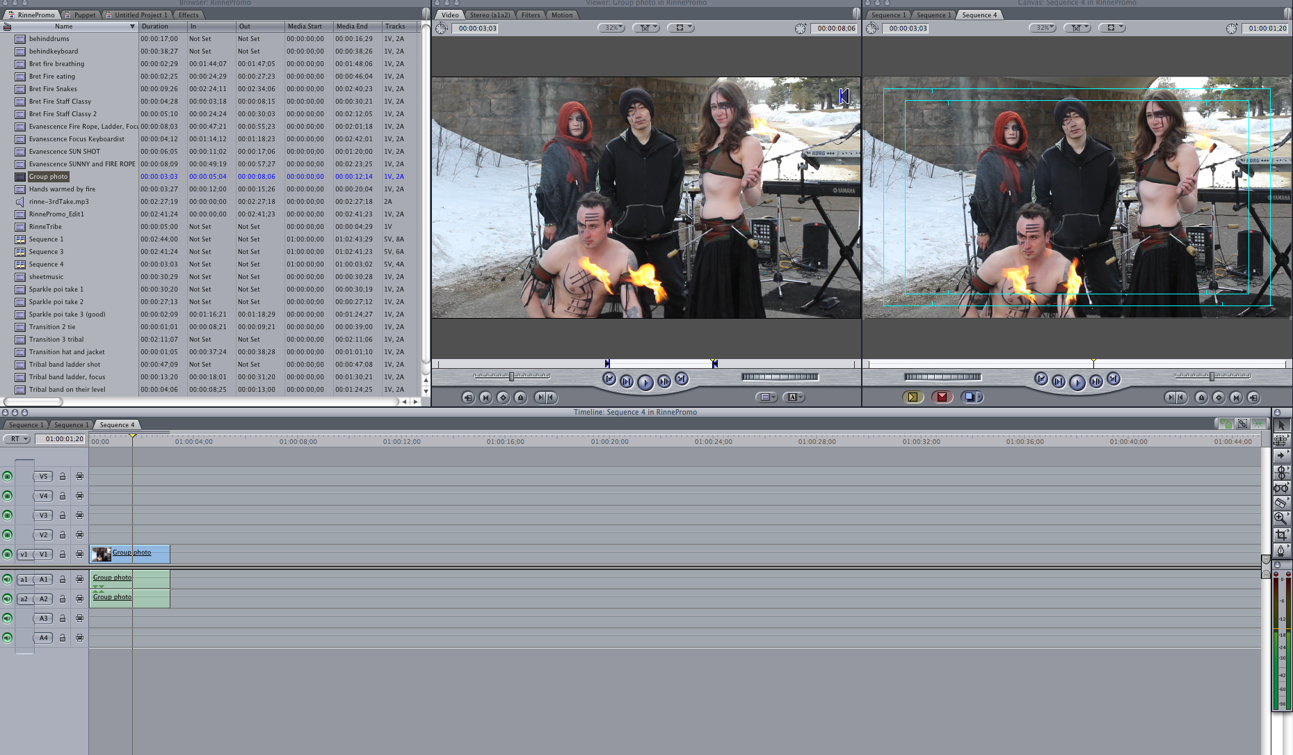

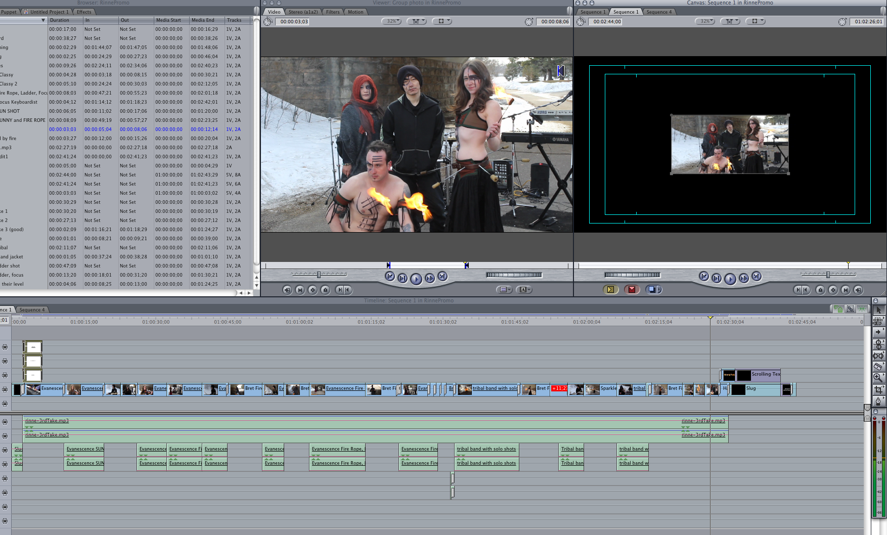

    I'm attaching two screen shots. Bottom one is of the footage, and top one is the edited project and the footage as it's all wonky now.
    I think something readjusted when I added a fade in, and fade in text in the beginning of the project without a slug (at first, you'll see there's one there now, but I'm sure the damage is done). I found the sequence settings changed from the original setup, so I changed them back but that didn't fix my issue, and now the footage is wonky and tiny.
    I am on a Mac OS X Version 10.6.8. I don't think I used any FCP templates, I just opened a new sequence, so whatever the default may be since I installed it. I export as H.264, 1920x1080 HD, Audio as AAC with all the 'Best' settings.
    Anything I should try? Otherwise having read so many help forums and try this or that tutorials, I'm ready to just re-edit the dang thing. =( I also though about backing my Mac up a couple days to before I made that change, but I didn't have Time Machine on. Alas. Click image for larger version
