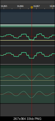

  23. Agree with Turk. Incorrect interpolation. Here's what your 12 bit and analogue -> 16 bit waveforms look like up close.

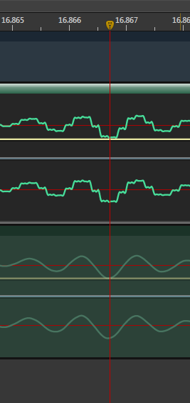

    Finally got to hear those both on a normal/good system - It sounds to me like there could be ALIASING going on in the "tinny" example, in addition to the 12bit "granularity". Aliasing is intermodulation distortion caused by lower sideband reverse harmonics, or, if your sample rate is 32k then that means that your highest good, passed frequency is just shy of 16kHz. But what happens to the frequencies that are HIGHER than 16kHz? Such as 17, 18, 19, and up to ~20kHz (not that there ought to be much signal left there). In a GOOD system, an anti-aliasing filter will just cut those out ahead of time so they aren't part of the remaining equation.
    But if there is no AA filter, what happens is that any frequency higher than 16k (= Nyquist freq = 1/2 Samplerate) will have it's frequency folded down below the Nyquist. So 17.5kHz = 1.5kHz higher than 16kHz. That 1.5kHz is now subtracted from 16kHz, giving a brand new 14.5kHz signal ADDED to the remaining good signal. And there is no real good way to ever get this out again! BTW, this is similar to the additional artifacts output by a "ring modulator", for those who have ever used one of those. And I won't even go into the possibility that this could continue ad infinitum folding back up and back down again, etc.
    I truly hope that I'm wrong on this and that you can salvage your work by finding a good audio app that can properly recognize the 12/32 stream(s) and upsample the 12/32 to 16/48 with good SRC filtering. Otherwise, I think you are screwed.
