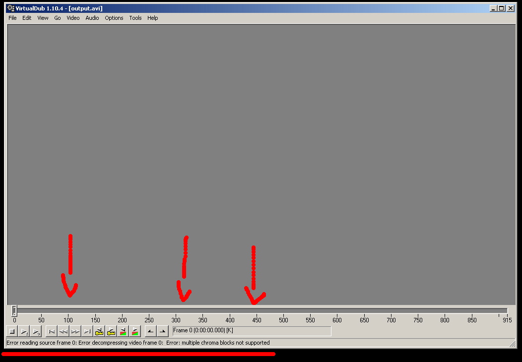

    considering my source https://dl.dropboxusercontent.com/u/39871584/C0020.mxf
    I use ffmpeg to:
    ffmpeg -i c0020.mxf -vcodec mjpeg -pix_fmt yuv422p -q:v 0 -an output.avi
    convert .mxf in mjpeg
    But when I try to open it in virtualdub I get this error:
    [Attachment 24636 - Click to enlarge]
    multiple chroma blocks not supported.
    Can I enhance the encoding in FFMPEG so virtualdub can open output.avi correctly, of course keeping the mjpeg encoding ?
    thanks
    ps. to decompress, in virtualdub, I use the internal decompressor (option, pref., avi-->prefer internal decoders)
    please I like to use internal mjpeg decompressor, not other decompressor

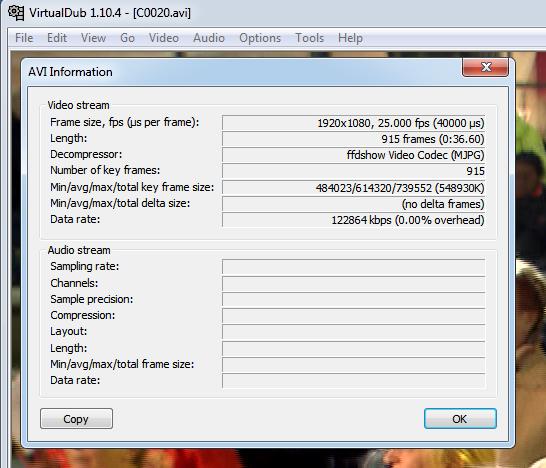

  2. I used your command line on the same source file. VirtualDub had no problem opening the AVI. ffmpeg was used to decode it.
    I suspect VirtualDub's internal MJPEG decoder doesn't support YUV 4:2:2.

    However it's strange that virtualdub can not decode with internal mjpeg decoder, wich means "multiple chroma blocks not supported" ?
    In effects does not seems a problem of 422, because ohters encoding (eg picvideo) in 422 are well opened by virtualdub. This problem is specific of the ffmpeg mjpeg. I have try to encode in mjpeg with virtualdub using the FFdshow mjpg and the risults is the same of the ffmpeg encoding ... what a terrible thing
