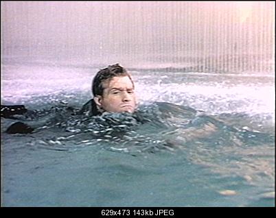

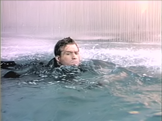

    I find that the setting that gets rid of most of the artifacts in other places kills detail in jets of water as seen in the pics below.
    Notice how the ripples in the water jets get washed/smoothed out. The setting that seems to make the biggest difference is noise reduction level in the Y channel but if I lower it, artifacts get introduced in other areas. I also run into this problem with video of waves at the beach, where it interprets the foaminess at the edge of the breaking waves as noise.
    Any suggestions? Thanks.

    No surprise. Fast moving water has much visually in common with noise. NeatVideo's job is to smooth the noise, so of course it is going to smooth fast moving water in the video.
    That is one reason waterfall shots are REGULARLY used in test suites to objectively compare the load & loss in quality when working with compression.
    So, the only real way to limit loss of detail there is less compression/higher bitrate/better compression efficiency.
    Not sure what the compression is going to change. This is a screen shot directly off Virtualdub working from an avs file before it's been saved to any particular format. The original video referenced in the avs file is a DV avi capture from VHS.
    Are you saying there's really no way to avoid this in using Neatvideo?

  7. When the detail is similar to the noise, the detail will be eliminated along with the noise.
  8. Originally Posted by brassplyer View Post
    Apply different settings for different sections of frames
    If you want more accuracy within frames, you have to use masks to be more selective
  9. Turn off or lower the temporal component of Neat Video.

    When using Neat Video, what you define as your noise profile makes a WORLD of difference, and I say that with CAPS with no intention to be overly loud without reason.
    Which is why, in this case, a video sample would be more than ever helpful for us to help you. And if, in your clip, you have a segment that has a big piece of "flat" background - all the better to set the noise (and ONLY the noise) benchmark.

    If you set up a bad noise profile, and overly aggressive settings, which is likely to happen if users assume Neat Video is simplistic, then you would be correct. If you can find a nice flat background (as was mentioned in my last post, and is KEY with Neat Video), or three or four different ones in the stream for your overall profile, set correct parameters for the Y and Cr/Cb, practice it to tweak and learn its rich assortment of settings, then Neat Video will induce very minimal damage to detail - at the compromise of removing a heck of alot of noise and chroma dancing, and other ills.

    Which is why I'm eager to try a sample here. However, if there's not any flat background to work with in the sample, then Neat Video will not be impressive.
