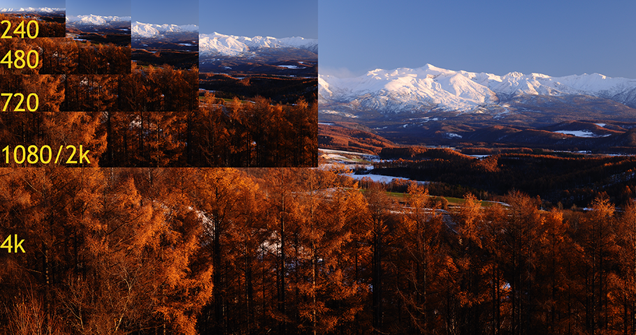

    So the below examples may help...
    Recently, while I was spec'ing out cams to decide the resolution requirements for a job I planned, I wanted to be clear about what was the level of acceptability for whatever resolution I chose. Unfortunately, most comparative examples of resolution demonstrate the size differential (see below):
    (note: this was scaled down to fit the usual browser window size, as a 4k width would be unwieldy)

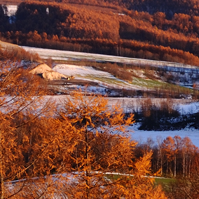

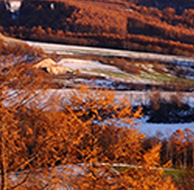

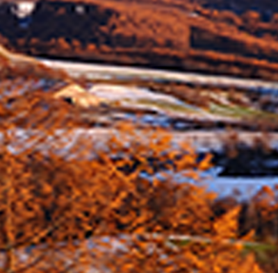

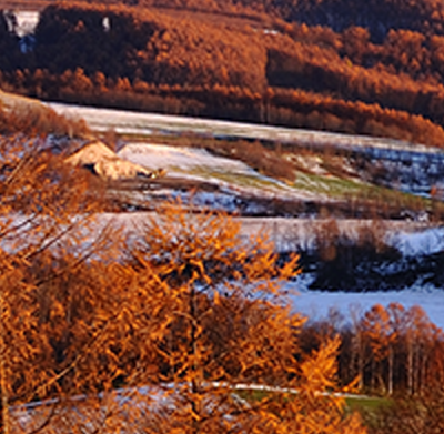

    While this is helpful for certain things, it DOESN'T explain the comparison between resolutions in terms of equivalent full-screen DETAIL, which is what I was needing, and what I believe many consumers mistakenly ignore until it is explained to them. So here goes:
    #1 SD CIF or 352x240

    #2 SD D1 or 720x480
    #3 HD 1280x720
    #4 HD 1920x1080

    #6 4k 4096x2160
    All images are taken from a master 6k/8k still and sized down then blown up to equivalent frame sizes, using the same downrez algorithm and the same uprez algorithm. What you are seeing is a (~200%?) blown up section from the center of the 4k screen - just to the right of the 1080 overlay.
    I think this should make it clear to the OP what the difference between 1920x1080 and 640x480 (or its nearest equivalent here: 720x480) is - Quite a LOT!
    Hopefully, it will help others in their understanding of resolution and in deciding which way to go WRT cameras, rendering, etc.
