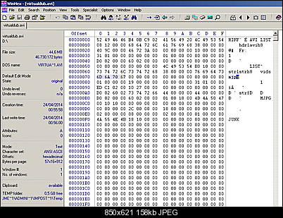

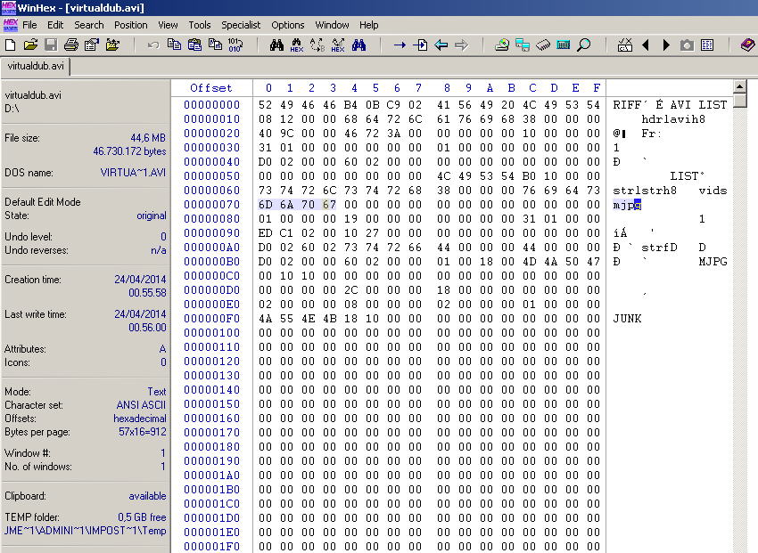

    I was looking for a program that I can modify hex values of an .avi file from mjpg to MJPG because my NLE IS cAse SenSitiVe and use the internal mjpeg reader only when recognize the MJPG string, and not mjpg (if found "mjpg" use external VFW or directshow codec).

    I need to build a batch file so it automatically modify (from mjpg to MJPG) the file o:\temp.avi, is exist a program than can do this?
    e.g. I launch c:\cat.bat, press the return, and it automatically change o:\temp.avi without doing anything else
    This because files generate in virtualdub have alwais the word of fourcc tag in lowercase
    thanks

  3. VirtualDub has a built in hex editor. Tools -> Hex Editor...
  4. You can also use AVI FourCC Changer.

    Another option is to batch ffmpeg -vtag "MJPG" with -c:v copy -c:a copy, but ffmpeg does not allow in place editing (slower because it has to stream copy audio/video)
