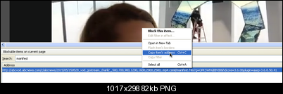

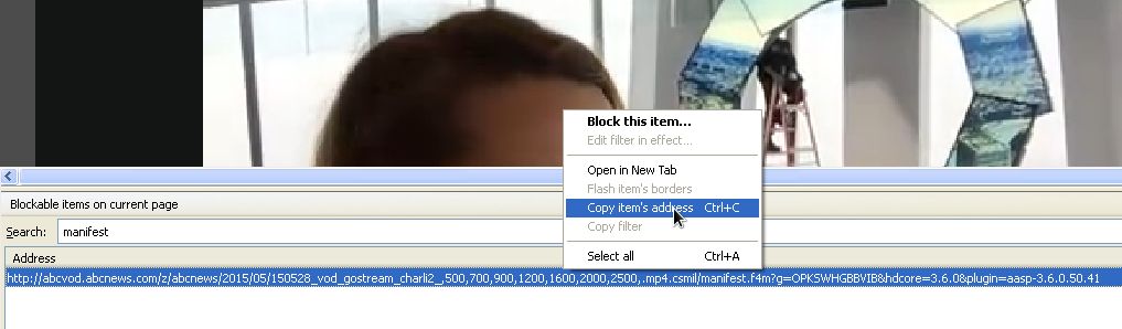

    livestreamer "hds://http://abcvod.abcnews.com/z/abcnews/2015/05/150528_vod_gostream_charli2_,500,700,900,1200,1600,2000,2500,.mp4.csmil/manifest.f4m?g=OPKSWHGBBVIB&hdcore=3.6.0&plugin=aasp-3.6.0.50.41" best -o inside-dizzying-heights-world-trade-center.flv
