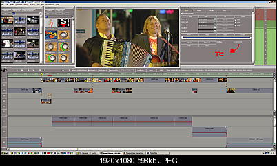

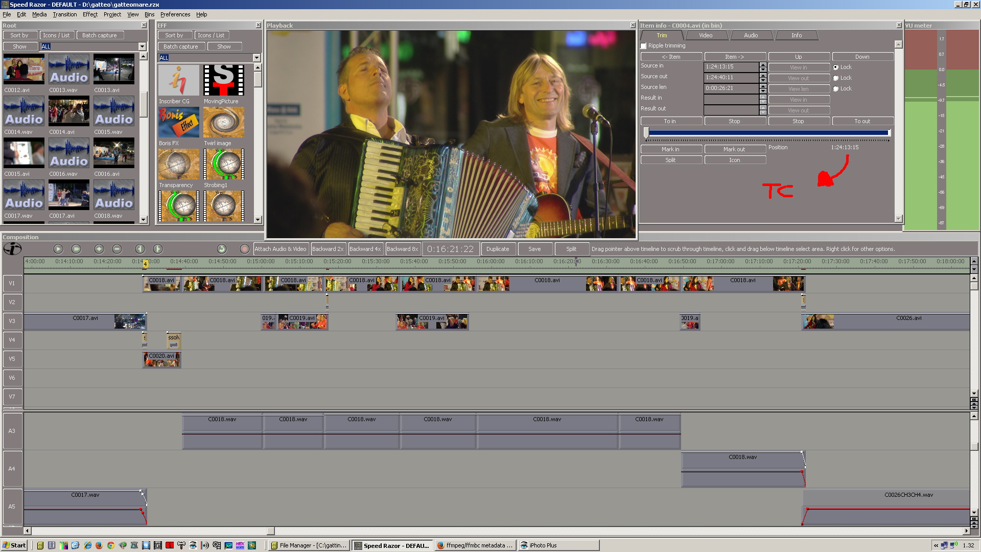

  17. a little yes.. i'm interested to change nle but I have repeated genomic sequences of cat.. I will change slowly nle. In the meantime, however, the change of speed razor, now, it works perfectly. I had to swap and change some. dll taken from another dinosaur .nle In Sync Blade (SR.dll, callback.dll, rzfile.dll, DVSync.rzf,scaleconverter.rzf) initially have a lot of problem (jerky playback, crashes). In recent months, there was only the problem of the timecode of the clips, but with this the problem is half-solved:
    There are month that I'm trying the machine and is stable.
    Speed Razor is absolutly the best in audio manage into the timeline: for news, with little time available this is crucial. The problem of this is my modified version is the "funnel hood" of the mjpg. However to the naked eye I challenge you to find differences.. except you have the cat's eye ^^
