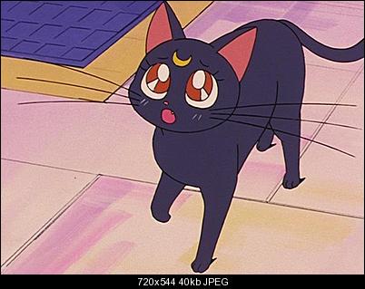

  1. I used this script to deinterlace my DVD but there are still some remaining interlaced frames?
    SetMtMode(5,10)
    LoadPlugin("C:\Users\Ryan\Downloads\video editing\MeGUI_2418_x86\tools\dgindex\DGDecode.dll")
    LoadPlugin("C:\Program Files (x86)\AviSynth 2.5\plugins\TIVTC.dll")
    LoadPlugin("C:\Program Files (x86)\AviSynth 2.5\plugins\MSharpen.dll")
    DGDecode_mpeg2source("C:\Users\Ryan\Desktop\VTS_03 _2.d2v")
    SetMtMode(2)
    AssumeTFF()
    TFM()
    TDecimate(mode=2, rate=23.976)
    Crop(2, 0, -2, -0)
    Spline64Resize(720, 544)Click image for larger version
  2. I don't see any interlacing in that picture but I'll take your word for it that it's there. What happens when you do this instead:
    TFM()
    TDecimate(Mode=1,Cycle=25,CycleR=1)
