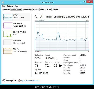

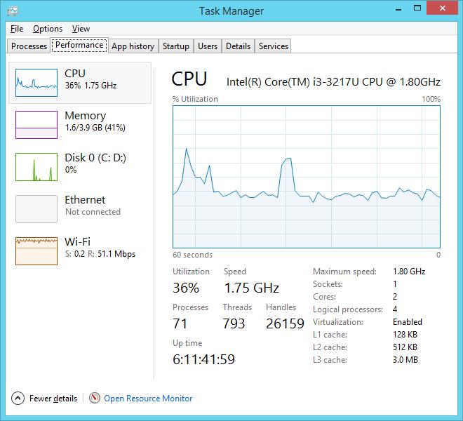

    Since I hadn't tried this in a while, I transferred a Blu-ray .m2ts file of Jurassic Park 3 to my server. The only wireless I have set up is my laptop presently. I was able to stream high action scenes to my laptop from the server at ~50Mbps. My laptop connection is rated at 72Mbps, so that was pushing it.
    It played it back full screen with MPC-HD 64 bit player with no stutters or dropouts. VLC couldn't handle it and just locked up. My old laptop wouldn't do this and this new one with W8.1 isn't that fast and uses a Intel HD Graphics 4000 card and a Antheros Ar9485 Wireless N adapter.
    The router I'm using at present is a Actiontec Q1000 from the ISP.
    My WDTV Live is an older model, no WIFI, though I have a couple of WIFI USB N adapters I could probably try.
    A screen shot of Task manager at a fairly high action part of the movie with the .m2ts file. I would say streaming a BD rip should work.
