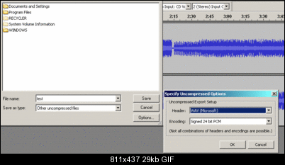

  18. Originally Posted by clashradio View Post
    The drop-down option for WAV is worded as "WAV signed 16 bit PCM". I've gone in the Options mode, but there's a message that says "if you need more control over the export format please use the "Other uncompressed files" format, but that doesn't lead anywhere.
    Haven't read through the whole thread, but was your original question answered?
    Exporting while choosing "other uncompressed files" and then selecting "Options" should give you lots of choices.
