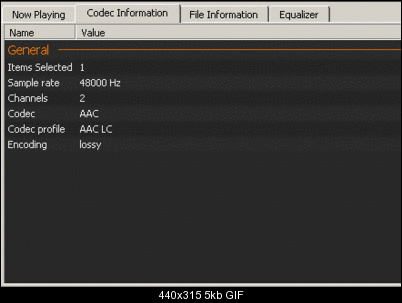

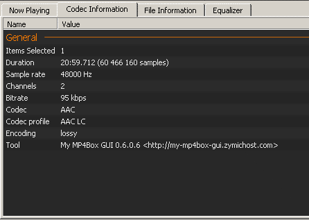

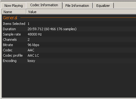

    Here's what the audio in an MP4 looks like as reported by foobar2000.

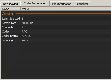

    Here's what foobar2000 reports for the extracted AAC (I used My MP4Box GUI to extract it).

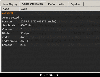

    Here's what foobar2000 reports for the same audio after it's been muxed into an MKA using MKVMergeGUI.

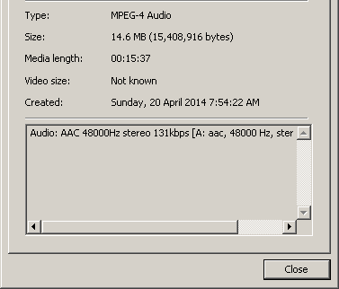

    Here's MPC-HC/MediaInfo taking a guess when opening the extracted audio. Note the duration is also wrong.

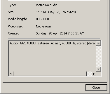

    And MPC-HC reporting again, after it's been muxed into an MKA.
    Okay.... the last one is a bad example. MediaInfo doesn't report the birate for individual AAC streams in MKV/MKA files. Therefore, neither does MPC-HC. I don't know why that is. Someone else might. It's getting the duration correct again though, and if I switch to the MediaInfo tab in MPC-HC's File/Properties menu, the "overall bitrate" is reported as being 96.2Kbps.
