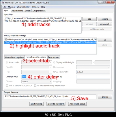

    What container is your final product? A lot of muxers have an audio delay option. I usually use MMG (part of MkvToolnix) to make MKV files. You can use VirtualDub to mux AVI files. MMG example:

  12. What container is your final product? A lot of muxers have an audio delay option. I usually use MMG (part of MkvToolnix) to make MKV files. You can use VirtualDub to mux AVI files. MMG example:
