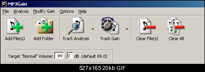

  7. MP3Gain doesn't just add tags to MP3s, it can adjust their volume. MP3 is the only format for which the volume can be adjusted losslessly (without re-encoding). The volume can only be adjusted in increments of 1.5dB (I can't remember the technical reason) but MP3Gain can adjust the volume to the nearest 1.5dB and then write tags so that players which support them can adjust the volume further if need be. 1.5dB isn't much though, so even without the tags it can adjust MP3 volume fairly accurately. My MP3 player doesn't support ReplayGain so I use MP3Gain to adjust the volume of MP3s before transferring them to the player.
    You'd need to run track gain on the files and use the function to apply the gain. Soundtrack audio tends to be a bit more dynamic than pop music, so when running MP3Gain on soundtrack audio I usually change the target volume to 83dB instead of the default of 89dB. Sometimes you can get away with 86dB but usually at 83dB there won't be any tracks "clipping" after the volume has been adjusted.
    I'd be very astounded if players paid any attention to ReplayGain MP3 tags in AVIs. They're not all that well supported by MP3 players. In fact, I'm not 100% sure the MP3Gain tags would be kept when muxing an MP3 into an AVI. I'd need to try it.
    When you're in Track Gain mode, the Track Analysis button writes the initial ReplayGain tags as it analyses. The Track Gain button adjusts the volume and re-writes the tags accordingly.
