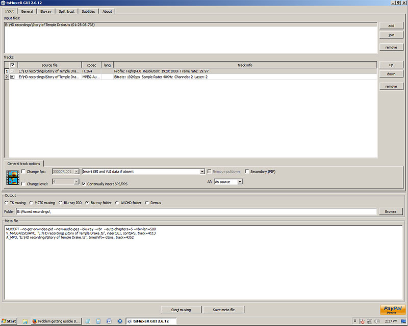

    [Attachment 24624 - Click to enlarge]
    Here's a screen cap of my tsMuxer settings

    What I meant is using software like TotalMedia Theatre, PowerDVD or the likes. You should be able to find a comprehensive list in the TOOLS section of this site. You should be able to have the software load the disc folder (NOT the individual file(s)) you have created. The benefit would be that the software would operate like a blu-ray player and you would be able to determine if the blu-ray plays as it should before you actually commit to burning it.

    When you used tsmuxergui you say you select Bluray as output format. I usually select avchd even when I later write the folders to a BD disc. To save discs if your Oppo has usb input you could also put the avchd on a thumb drive. I don't do that since I have a lot of re-writable BD-RE discs but apparently you need to make a folder called AVCHD (all caps) and put the BMVD and Certificate folders in it.

  9. Outputting as AVCHD is worth a shot. In the early days of Blu-Ray, Doom9 maintained a list of players that were touchy about various things, and the list was long. Dunno about the Oppo standalones.
