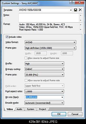

    i am done editing with vega pro 12 and now i want to render the video
    i want an output exactly same as the input, not more nor less bitrate/quality.
    but in vegas when i choose "AVCHD 1920x1080-50i" render template, and after even setting bitrate to 21,999,616 bps, my output video would have bitrate of approxiately 15414067 bps. how can i get same bitrate?
    and also the output video happen to drop frames after some second, like in game we have frame drop but audio will be normal

    actually, there is no "maximum bitrate" in the render window
    as the image below shows that
Name:	New Bitmap Image.jpg
    and i cant set more bitrate, and i FYI rhe default value for bitrate is 16,000,000
    x
