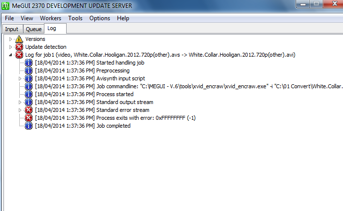

    Attached are the error's that I get with MeGUI, but read it could be because it was a portable version & AVIsynth isn't setup correctly & also need to make sure I use ffmpeg instead of directshow & best to create my own synth script but not sure on any of those just a thread I saw that sounded similar to my issue!
    Thanks for the advice on the other programs, I will look into them if I can't sort out MeGUI!

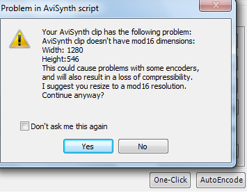

    Encoders expecting video height resolution that's mod16 isn't unheard of especially with mpeg4 asp. It's not as complex as it sounds.
    "Mod 16" means divisible by 16, no remainder. Modular arithmetic is common in computer programming. And in geek written docs and error messages.
    You may want to resize to mod16 or crop/add black borders.

  5. I can't see the whole log file, but "versions" has an exclamation mark next to it and "update detection" has an "x" next to it so it'd appear there's problems there. I could only guess as to what they are but MeGUI is pretty much self contained (including the portable version of Avisynth which it uses).
    The Haali Media Splitter is required for some file types but other than that you shouldn't need to have anything else installed (aside from a correct version of the dot net framework, which you probably do). It'd be helpful to see the "versions" and "update detection" sections expanded in order to work out what MeGUI is unhappy about there, but it doesn't relate to the "Problem in Avisynth script" warning you're seeing.
    Back in the dark ages, video needed to be mod16 (width and height both evenly divisible by 16) so MeGUI is warning you about it. It only offers that warning when you add an encoding job to the queue while the selected encoder is Xvid. You can ignore it and encode non-mod16 anyway. The warning message is a bit deceiving because it implies the mod16 issue is an encoder issue, when in fact Xvid will happily encode that way (the warning message itself has probably been the same since MeGUI was first created and it should be changed). The issue is a decoding one. If your player doesn't mind, you can happily encode non-mod16. Generally as long as you resize to mod4 dimensions (width and height both evenly divisible by 4) you shouldn't have any problems.
    Most DVD players are standard definition only, and most will only support a maximum width of 720. So normally you'd need to resize to an appropriate width and height. 720x400, 720x384.... that sort of thing. If it's a media player which will play higher resolutions, then obviously you don't need to resize down.

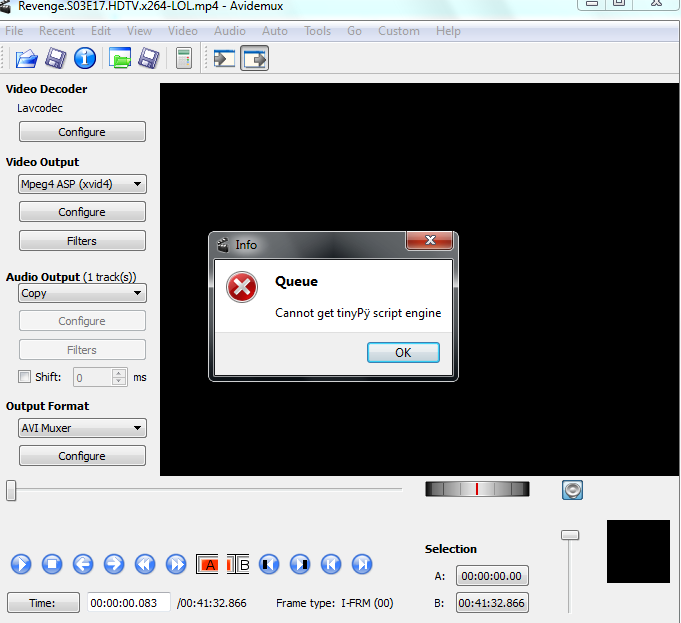

    Well I tried AVIdemux but got the attached message when I tried to queue it?
    But then I tried install Haalisplitter & AVIsynth & went back to MeGUI but still had the same issue, sorry those other errors are just cause I don't have the computer connected to net & don't allow updates!
    But then I found an old version of MeGUI I had lying around (was x86 version) & thought I'd try it anyway & BINGO it converted a 40minute show in 6 minutes per pass, not to mention the picture quality was better than AVS & the file size & bitrate was a lot lower (in percentage comparing file sizes).
