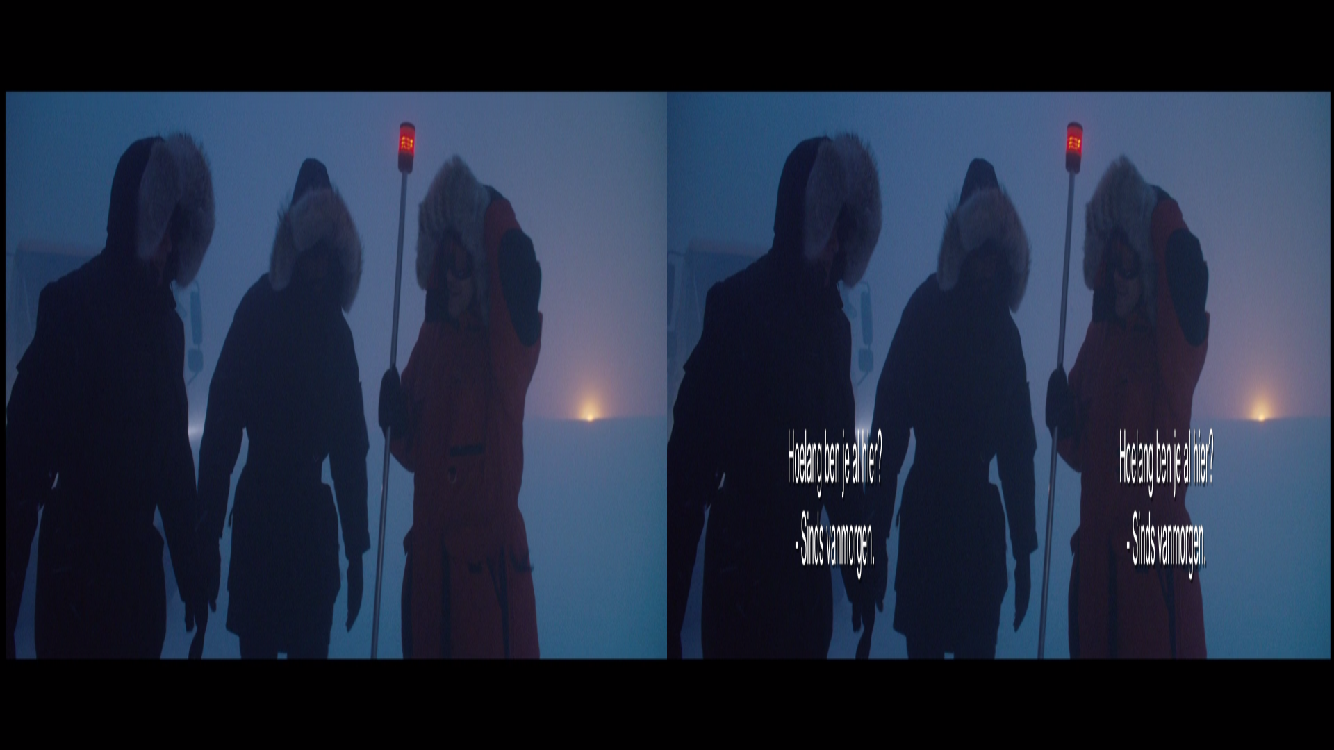

    Hi there,
    I have a video file on my computer that has over-under 3d. I am used to play side-by-side 3d video's with subtitles using ffdshow in stereoscopic player. I did all the preferences, so the player knows it's a OU file, and he has to play it like a SBS video, but the subs still won't work. I tried to play the subtitles but they were in SBS mode but only on one side. I've got no idea how to play these subs.
    Thnx!
    (sorry for my bad english, i'm dutch )
Name:	cap amer. 1.png

    Just a wild guess, but I'm thinking the sub is already Pre-Formatted for SbS, but the ffdshow is again applying the SbS formatting to what it thinks are 2D subs?

    the video plays fine without the subs, so the problems have to be somewhere in FFDshow.
